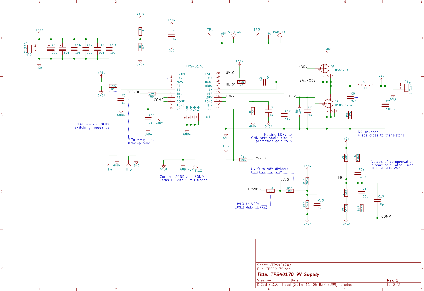

I have  a TPS40107 design that I'm experiencing FET shoot-through on. Here's scope traces of both FET gates:
Blue trace is upper, yellow is lower. Lots of ringing on both gates.

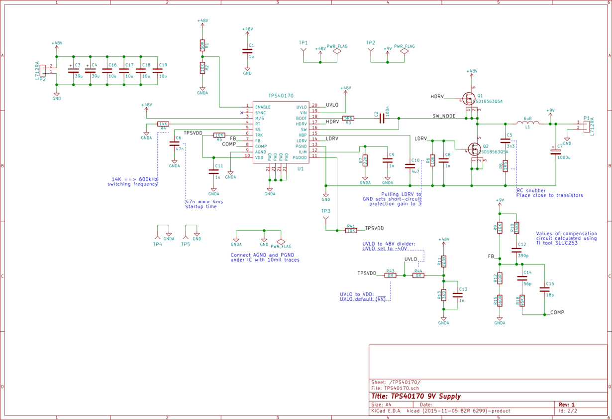

Here's the schematic:
The design is for a 48V input, though I'm currently using 15V to prevent the FETs from burning out.
I've experimenting with changing the value of the RC snubber, but there is no/very little change to the behaviour of the circuit.

    First, can you take C8 off?
    The blue trace in your waveform is the voltage between HS gate and GND, we need to check Vgs of high-side FET.
    Please measure the Vgs of high-side FET and low-side FET at the same time.
    If you don't have a differential probe to measure high-side Vgs, please use two probes to measure high-sidge gate and SW, then get Vg-Sw=Vgs.

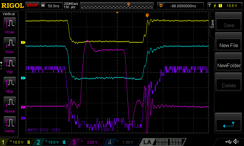

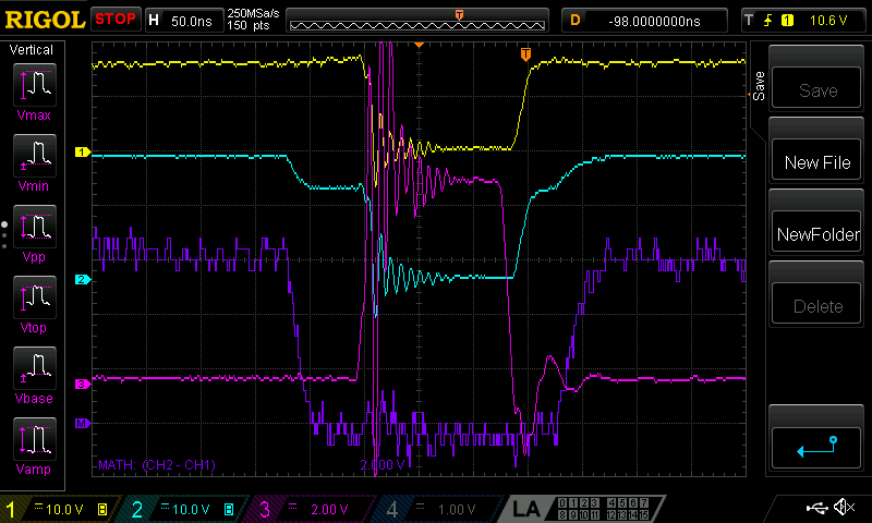

  • Sorry for delay in replying, I was diverted onto other projects.
    We don't have a differential probe, so had to use math function on the 'scope. As requested, here's traces for highside and lowside Vgs:
    On both images:
    Channel 1, yellow: Switch node
    Channel 2, blue: Highside gate
    Channel 3, pink: lowside gate
    Math, purple: Ch.2 - Ch.1
    I don't know how to interpret these traces, so hopefully they can provide information that helps you.
