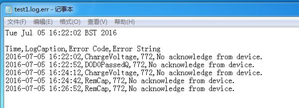

Hello, I have some doubt about the BQ34Z100-G1 learning cycle:
1、When calculate Chemistry ID,there are several errors on Battery management studio logging data file. All of errors are "No acknowledge from device".See the attach.
    What is the reason? Will it cause the failure of Chemistry ID calculation?

  • Hi Snow,
    1. There is no attachment. What steps are you taking to determine the Chem ID?

  • Thank you for replying.
    1, I am sorry for missing the attach. The errors show as follow:

  • 1. Was the log able to record the temperature, the voltage of the battery, and the current? If it was able to record those, you should be able to use the GPC tool.
