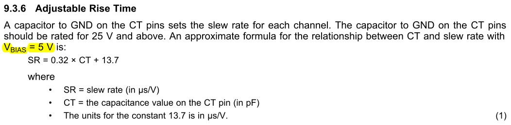

TPS22968 / Slew rate calculation at Vbias=2.8V

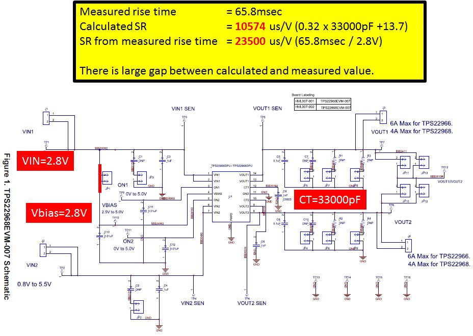

Please let me ask about formula to calculate slew rate. I found following thread and understand that the formula in datasheet can be used at only Vbias=5V.
Then I'd like to know the formula at Vbias=2.8V because my customer has considered to use with VIN=2.8V and so want to connect VBIAS to VIN.
