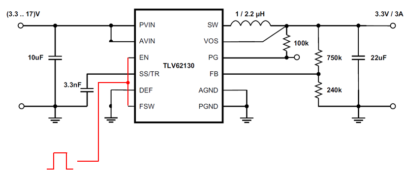

My customer has question about TLV62130A.
Could you tell me about questoin?
[Question]
- Is there any sequence requirement between EN and FSW?
  My customer considers to input High signal to EN and FSW pin from same signal rail.
  They know that if they want to set fsw=1.25MHz, they should connect FSW to Vout or PG.
  But they designed external control for FSW and EN in first prototype.
  So they have concern about this usage.
  *They are going to connect FSW to Vout or PG in next prototype.
