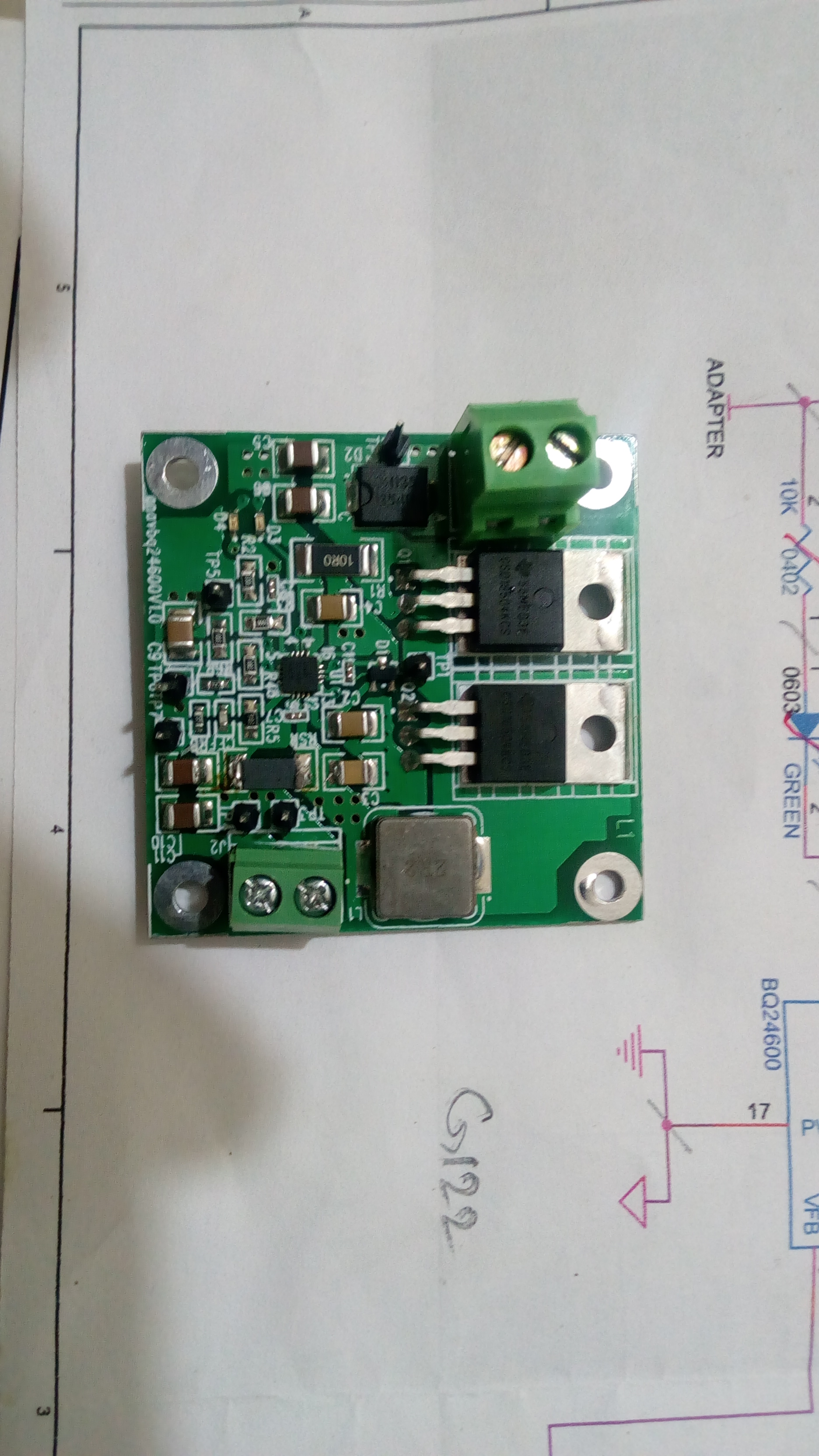

    I completed the design for schematic and PCB. can you review once and give your comments so i can move further for fabrication.please find the attached  schematic and PCB file.

    Mentor Graphics software is used to make the design. The .pcb file can be opened using Mentor graphics pads pcb viewer, which is free available at website. Here is the link  https://www.pads.com/downloads/pads-pcb-viewer/.  also i attach the gerber files.
    Please comment on design, so i can take next step of fabrication.

  • Vijay,
    You may need to add more copper pour for GND so that heat can be dissipated. Other than that, the layout looks good. I would place C8 and C9 closer to the Q1 drain.

  • Hi Steven
    I am able to make the PCB and it is working fine at 4A with .02E  Rsr . but when i change the Rsr with .01E for higher current i got 6-7A current. but the PCB is heating . i have 20Ah and 14.8 volt battery pack and i needed 10A charging current. i have some questions regarding the design:
    1.how to select the input voltage for charging 14.8 (4S) and 20 Ah battery pack for better efficiency.
    2. how to reduce the heating of Pcb board of charger. or how to minimize the power loss.
    3.How to decide the value of L and C out ( should i follow the instructions given at
    I attach the pcb and schematics. could you please tell me changes i need to make 10 A charger in schematics.

  • Hi Vijay,
    Can you measure the voltage at ISET and also look at the waveform at PH, VCC and SRN using an oscilloscope?
    To answer your questions:
    1. 20V input should be sufficient. You need to make sure your input adapter or source can handle the 10A charge current. You will need a 200W input source.
    2. To reduce heat, you will need to use more copper pour which can act as a heat sink. You can use a uniform GND plane layer.
    3. You can use the values at page 16 table 1 of the datasheet to find LC combination.
