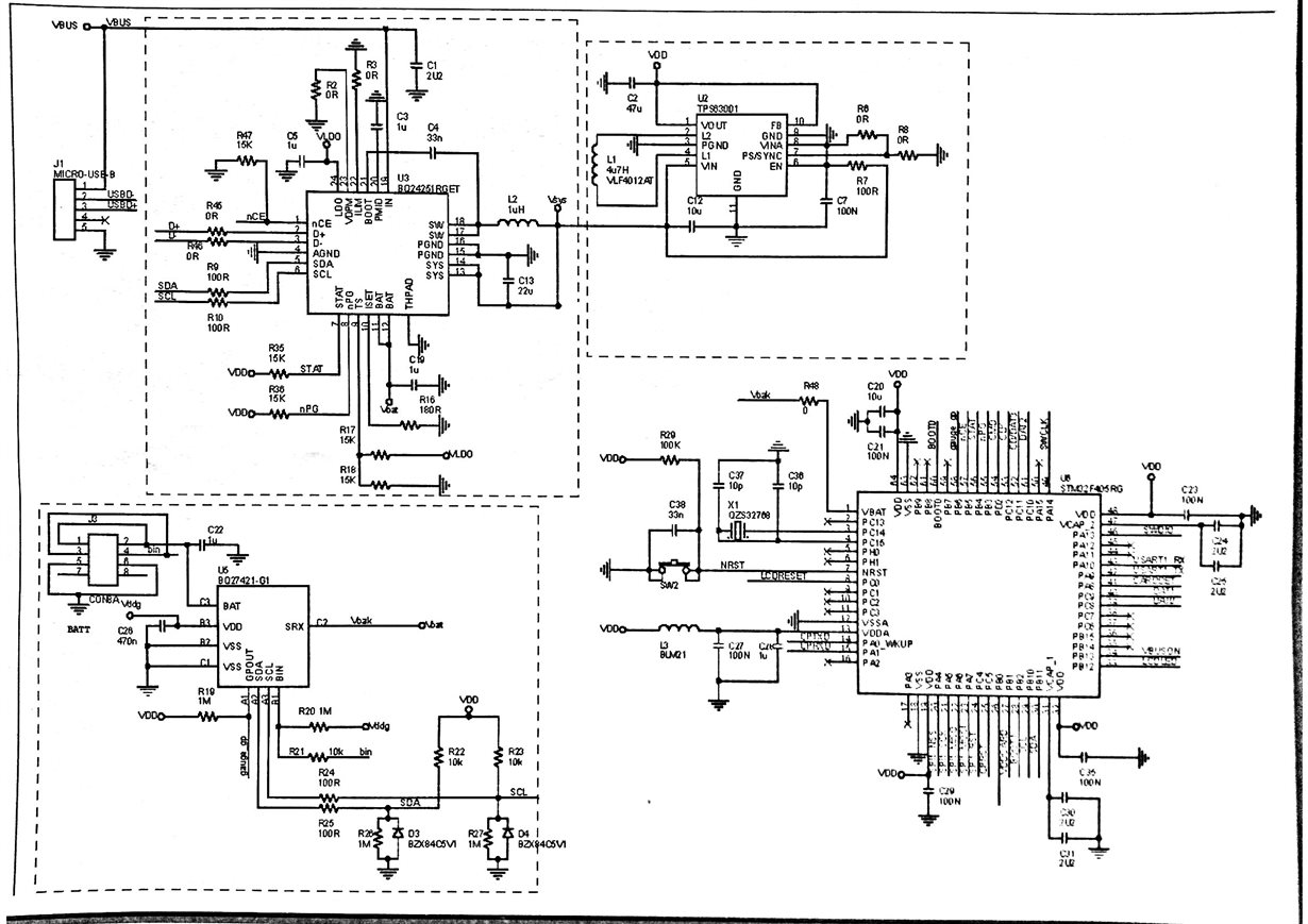

I am using a bq24251 ic in a system which i will describe below (i know it is not recommended for new designs, but unfortunately this is what the costumer has/wants):
-The system is powered from a LiPo battery - kokam SLPB526495, with protection circuit (tried one without the protection circuit, same results)
- current consumptiopn is 20mA ( know it is overkill with a 3300mAh battery, but it will have a loooong standby)
-Charging is done with a dedicated charger (5V, 2,1A and D+ and D- shorted together). It will be necessary to work with a PC USB connection, too(5v, 500mA) but for the moment I will be happy to make it work with the dedicated charger.
-between the battery and Vbat pin of BQ24251 I use a BQ27421-G1 fuel gauge (i2c connected)
-board processor is STM32F405
-another i2c slave is a LCD MCCOG420005A6W
-BQ24251 Vsys is connected to one TPS63001 buck-boost to output 3,3V. (It has a 10u capacitor on input)
BQ24251 setup
- ILIM and VDPM shorted to ground
- ISET to GND with 180ohm resistor
- inductor used is 1uH COILCRAFT 1812PS-102JLC (farnell code 2287053, for more info)
- capacitor used as recommended by datasheet (22u on Vsys, 33n between BOOT and SW, 1u on PMID, 1u on LDO, 1u on VBAT)
- TS pin is 50% VLDO (divider made by to two 15k resistor on LDO to GND)

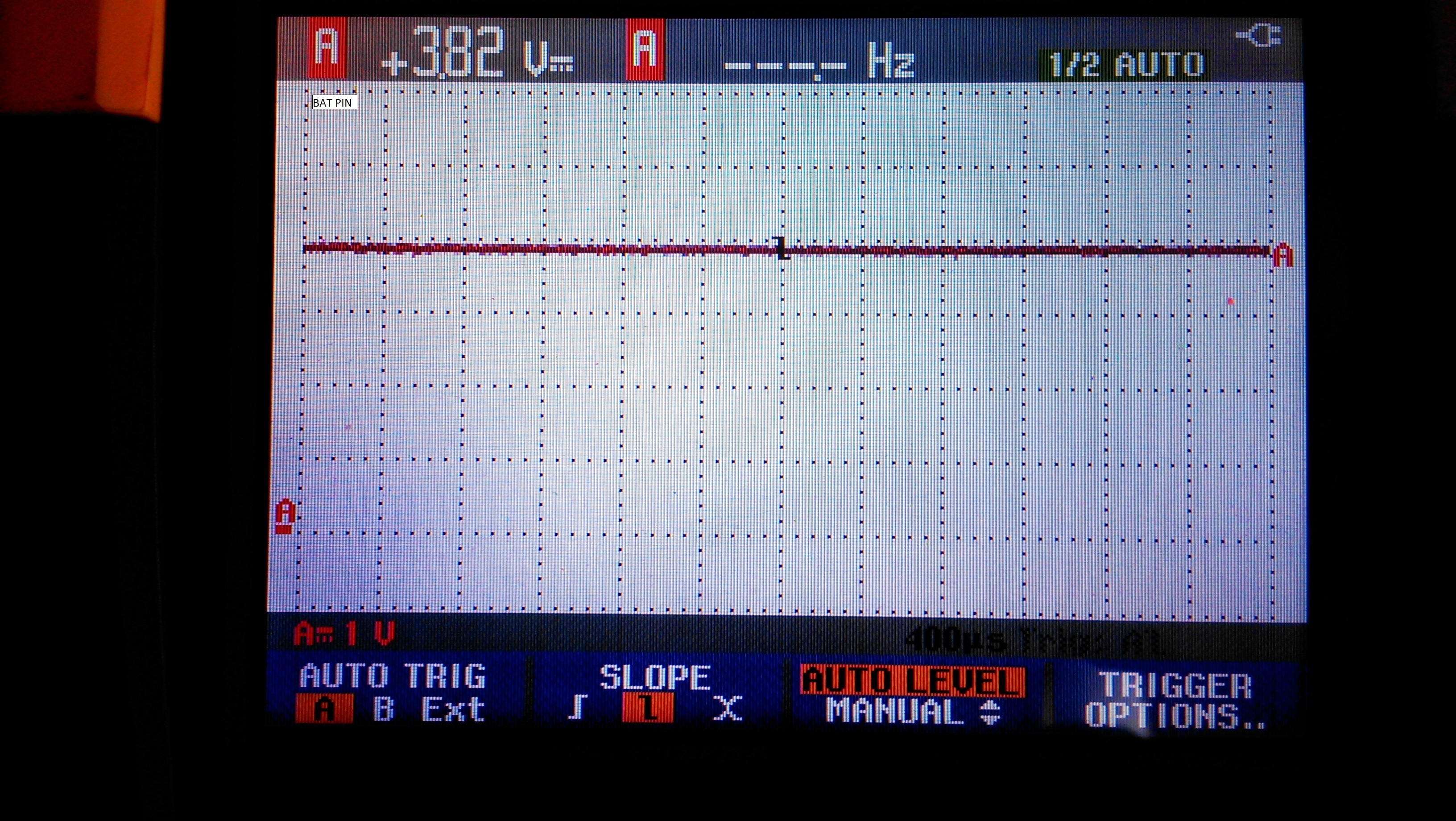

Now it says it is in charging mode, but there is no current flowing into the battery. The load is powered only by the battery. Form the charger it is drown only 3mA.

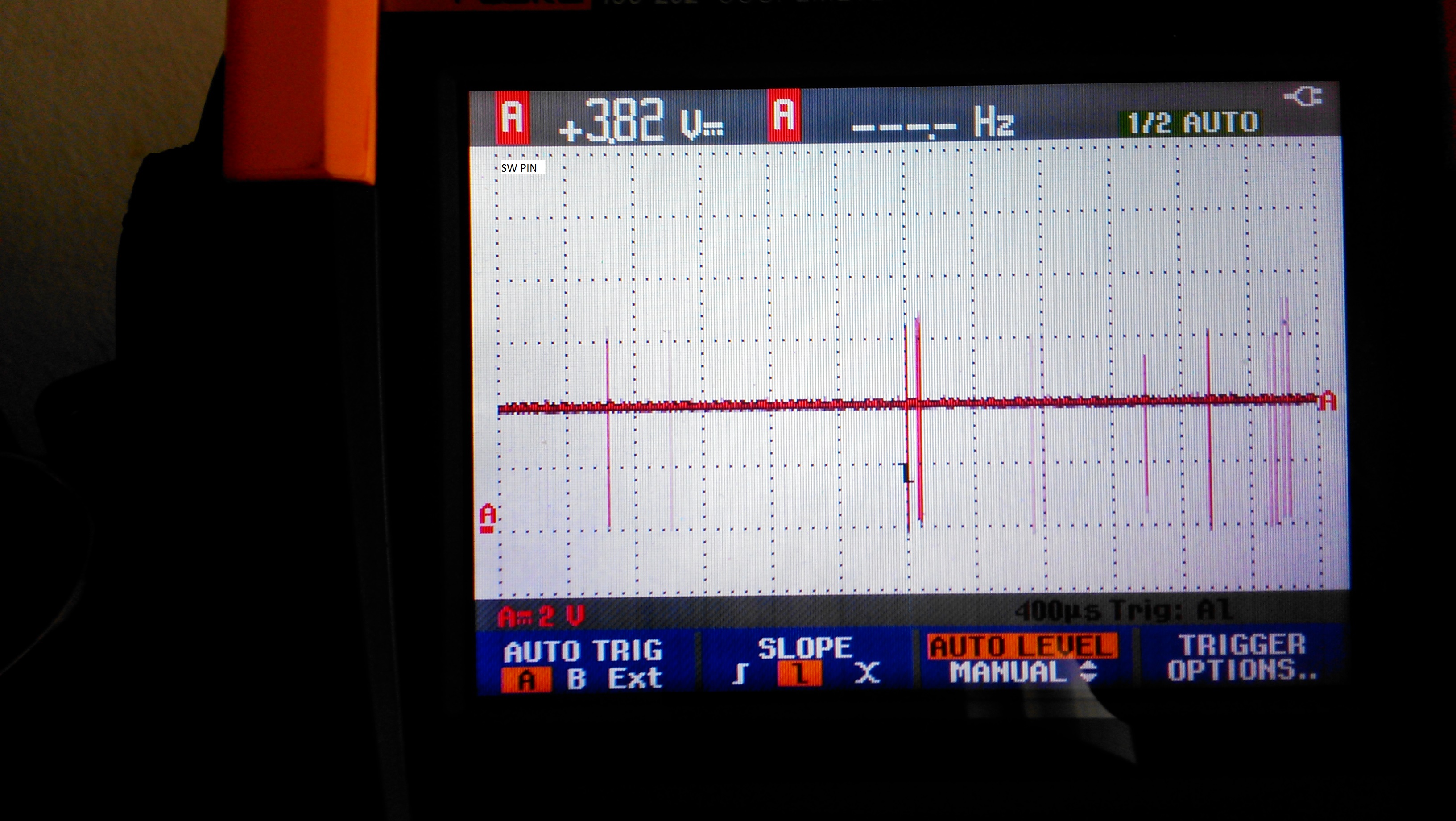

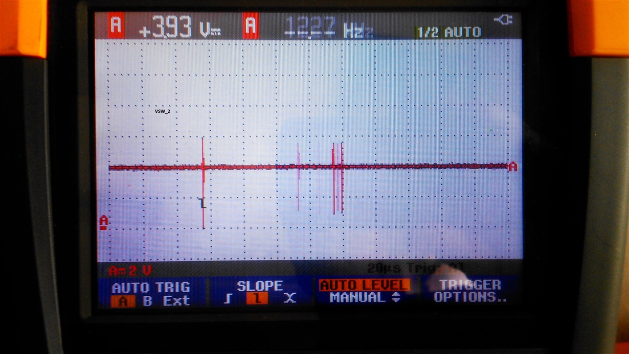

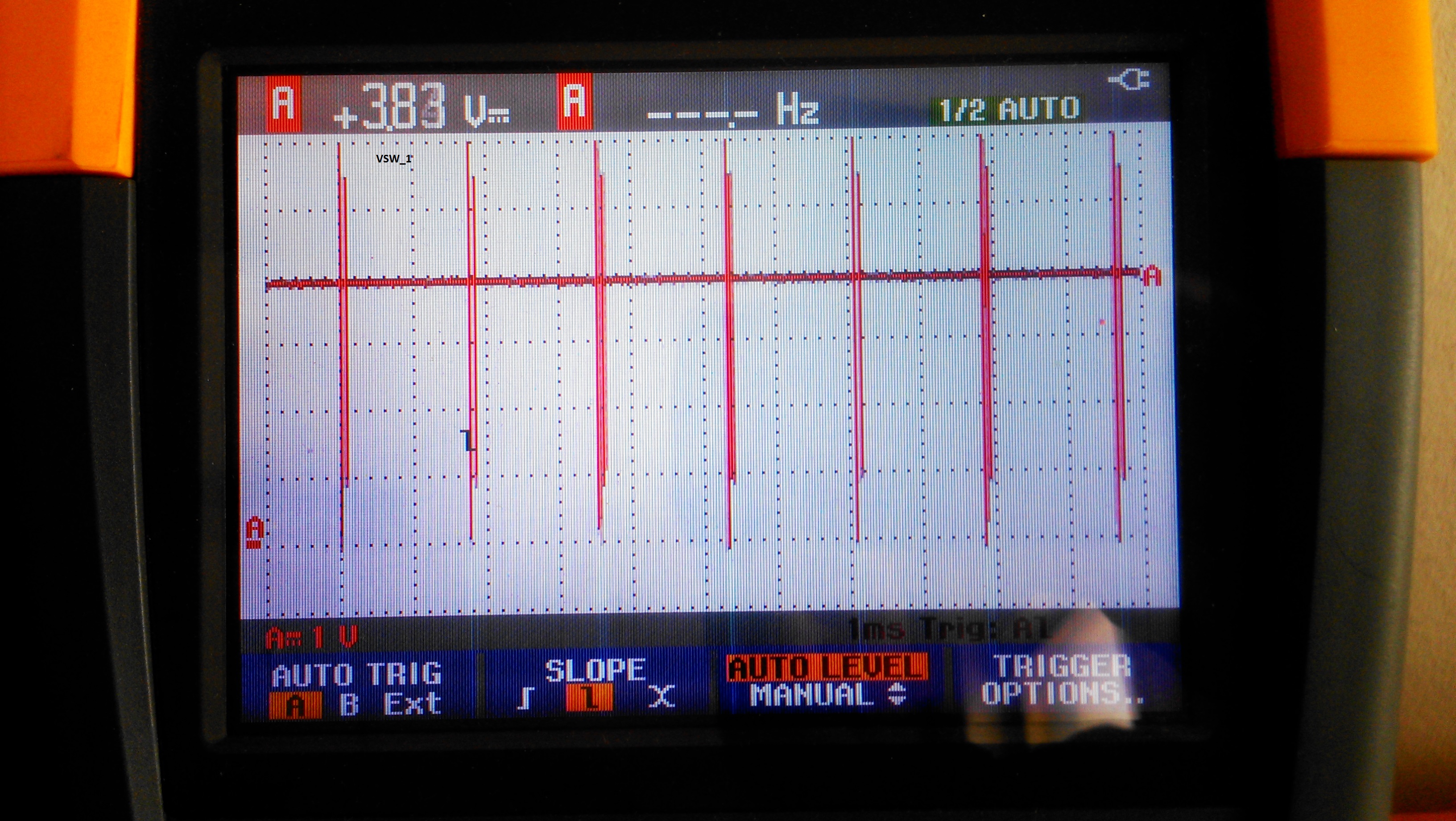

The SW pin folows the Vbat (it should be +100mV). It shows spikes with a frequency of 240-250 Hz, increasing sporadically to 500Hz.
Vsys is equal to Vbat.

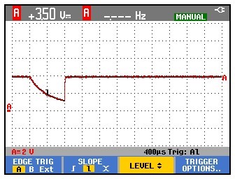

When the battery is more discharged (3,6V ), if I connect a load of aprox. 4 ohms, the consumption goes to almost 900mA. Then the charger start to kick in (freq on Vsw is 3MHz, now), and the 900mA are drown from the charger instead the battery. If I remove the load, the battery goes into charging with a little more than 1A.
If the battery is 3,8V the charger never kicks in (maybe if the voltage drops below 3,5 -3,6 but I don't have the patience to wait that long, and besides it is not ok).
The Power Good pin is oscillating when the 5V IN is applied.
It seems like the actual charging is started only if the battery is below 3,5V, which is not good at all, and not as it say in the datasheet (the fig 15 and 16 shows a something else). The Vsys should be a little higher then Vbat (at least 30mV in BATREG and 100mV in SYSREG).
The bottom line, when I connect the 5V on Vin, PG pin is oscillating instead of going low (5V output does not have any ripple, does not goes low, nothing visible on oscilloscope, and can give a little more then 3A), the BQ24251 says it is in charging mode, but the actual charging never happens.

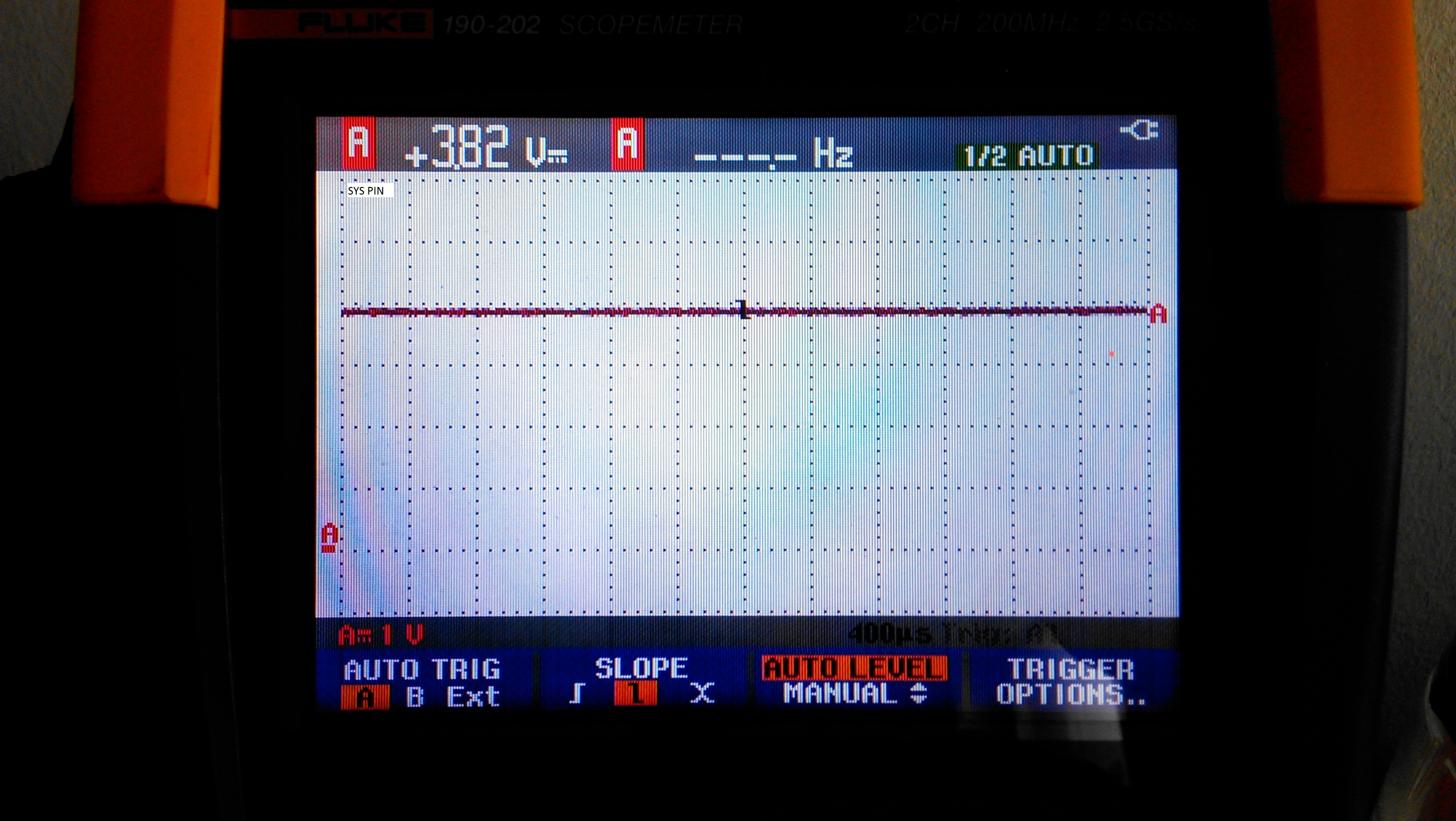

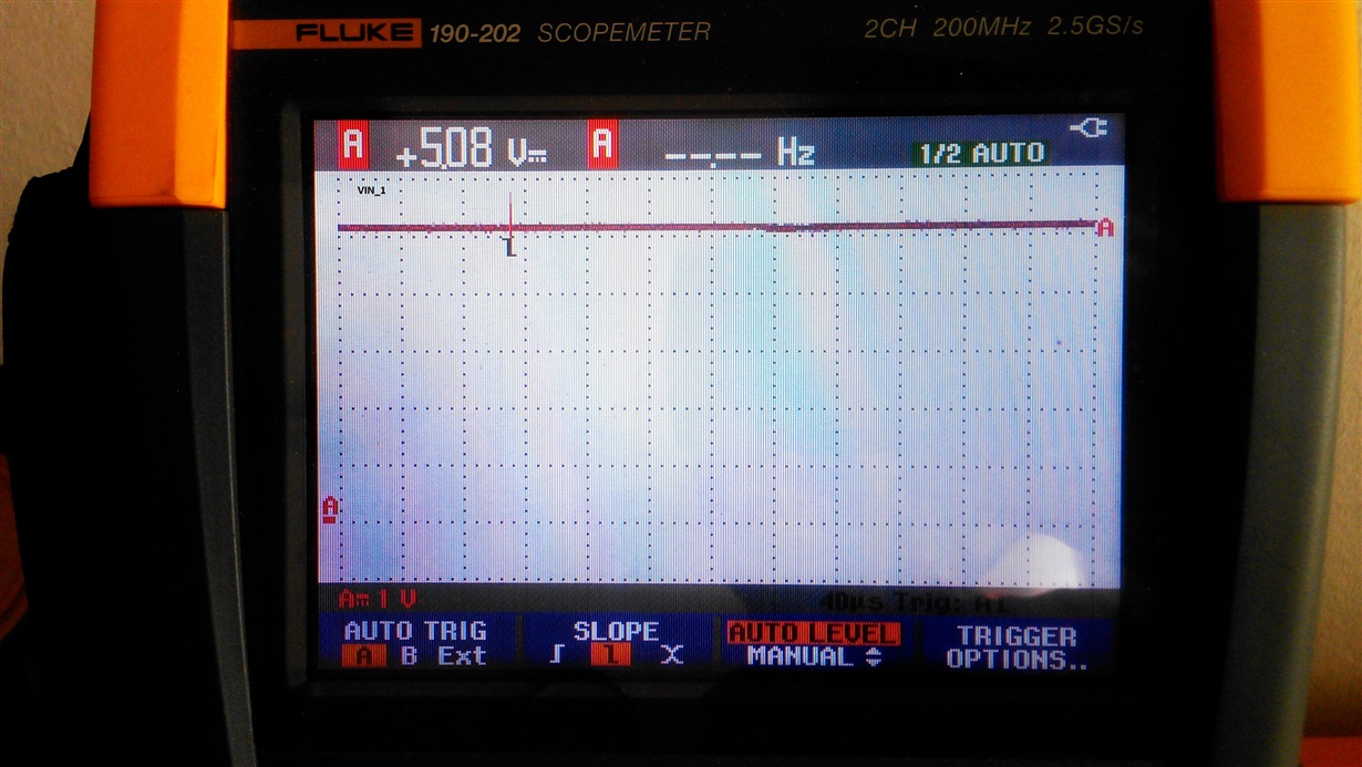

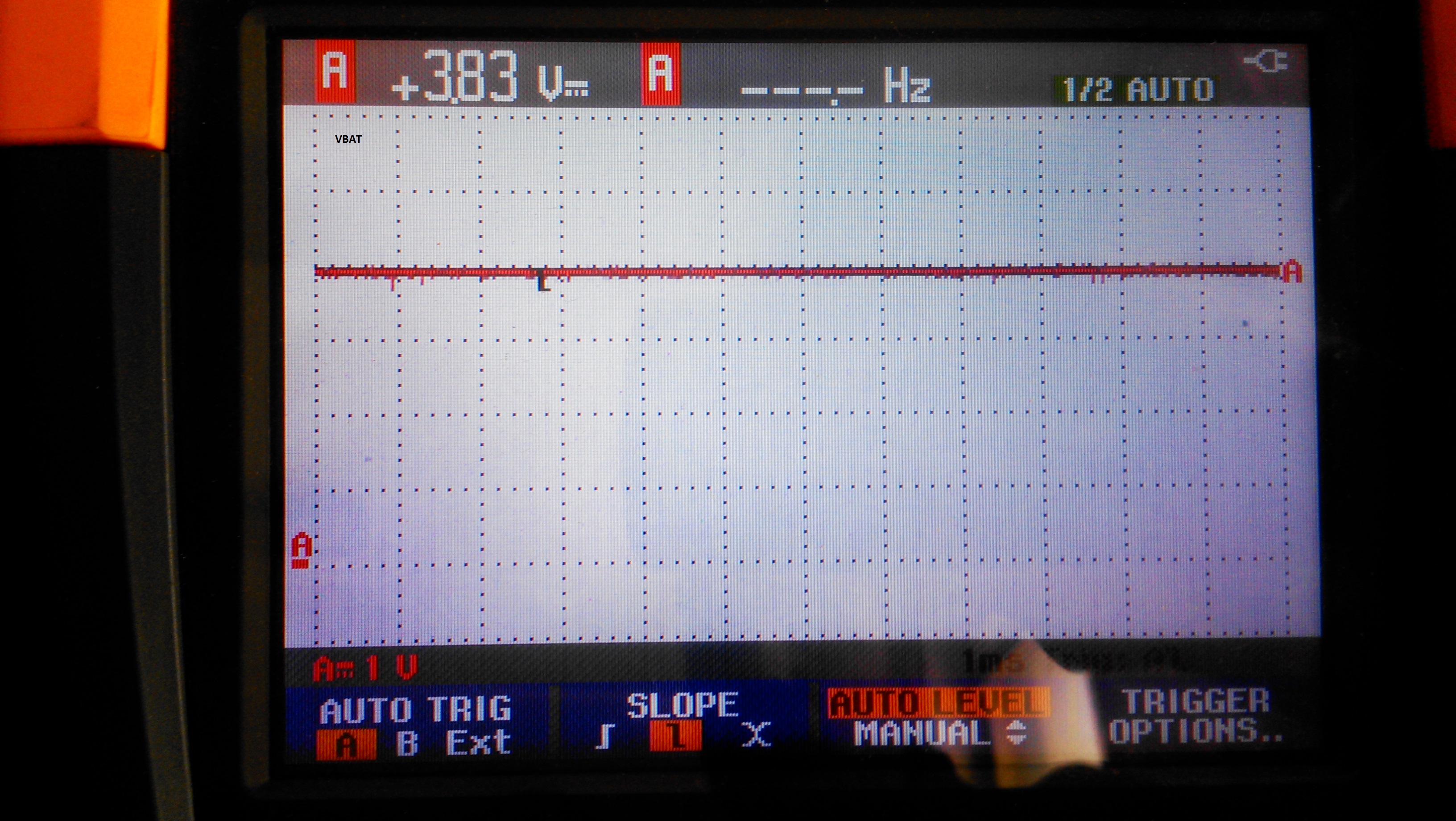

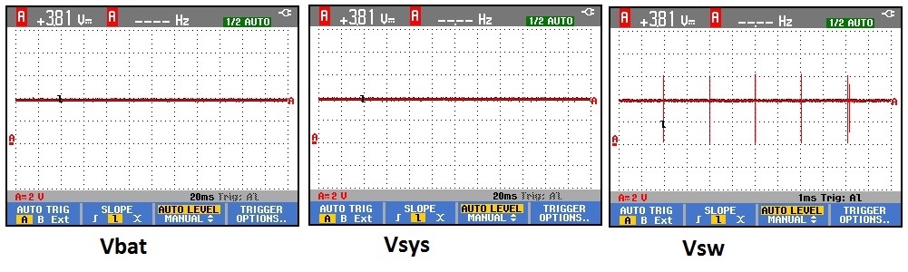

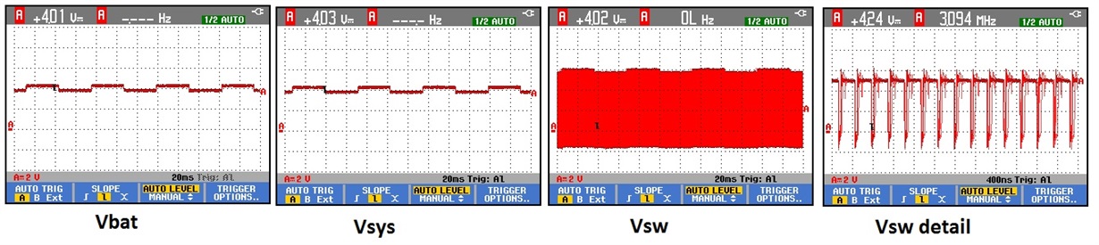

    I have tested the setup suggested earlier, like this:
    - VIN, 5V from power supply, directly to VIN pin (no USB connector, soldered thick wire directly on board)
    - VBAT from battery directly to BAT pin
    - Load disconnected from VSYS
    - i2c floating (remove R9, R10) USB D+ D- floating (remove R45, R46)
    - Pins 1, 7, 8 (CE, STAT, PG) cut off from the processor (kept pull down on CE and pull up on STAT and PG)
    - All pins like in schematics:
      - TS at VLDO/2 with a divider (R17, R18 15K each)
      - ILIM shorted to GND
      - VDPM shorted to GND
      - all pins with recommended capacitors (1u VBAT, 22u SYS, 33n BOOT to SW, 1u PMID, 1u VLDO, 2.2u IN)

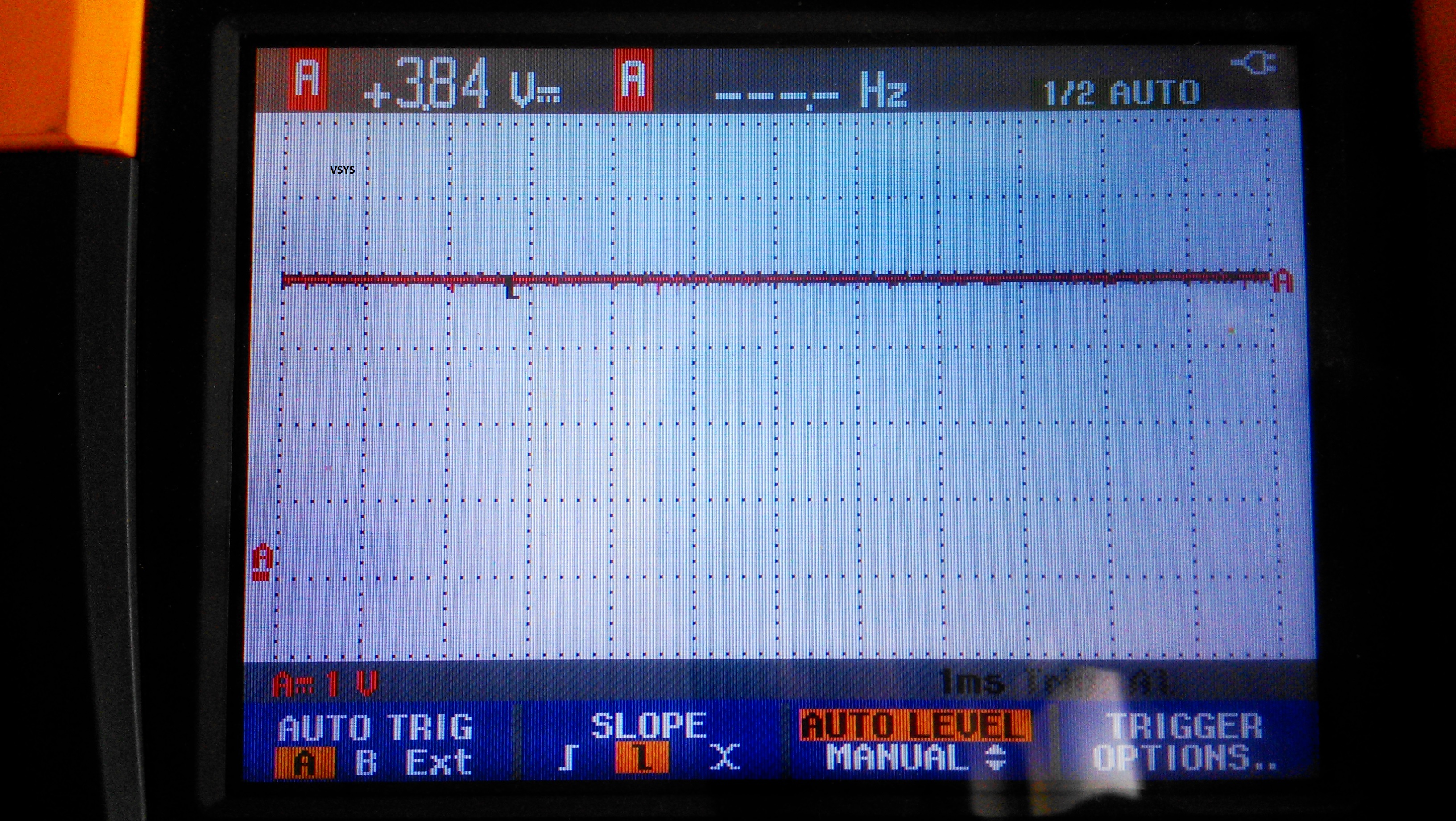

    I attached screens with VIN, VBAT, VSYS and VSW.
    The 0,01V difference between VBAT (3,83V) and VSYS(3,84) is actually caused by the fact that VBAT was somewhere between 3,83-3,84, and it was slowly switching between those two values. VSYS is following VBAT without any offset.
    Current drawn from IN was 3,67mA and from BAT was 0,06mA drawn from battery with IN connected and 0,01mA drawn from battery when IN is floating (strange). Any other currents are difficult to measure, because I have to remove components, solder them with wires so I can insert an ammeter, but I'll do it if necessary because I can't figure it out what is happening here.
    Thank you ,
    Doru

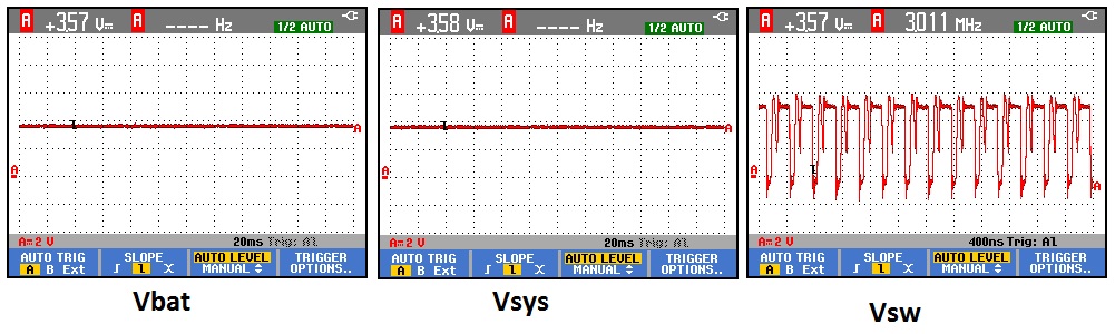

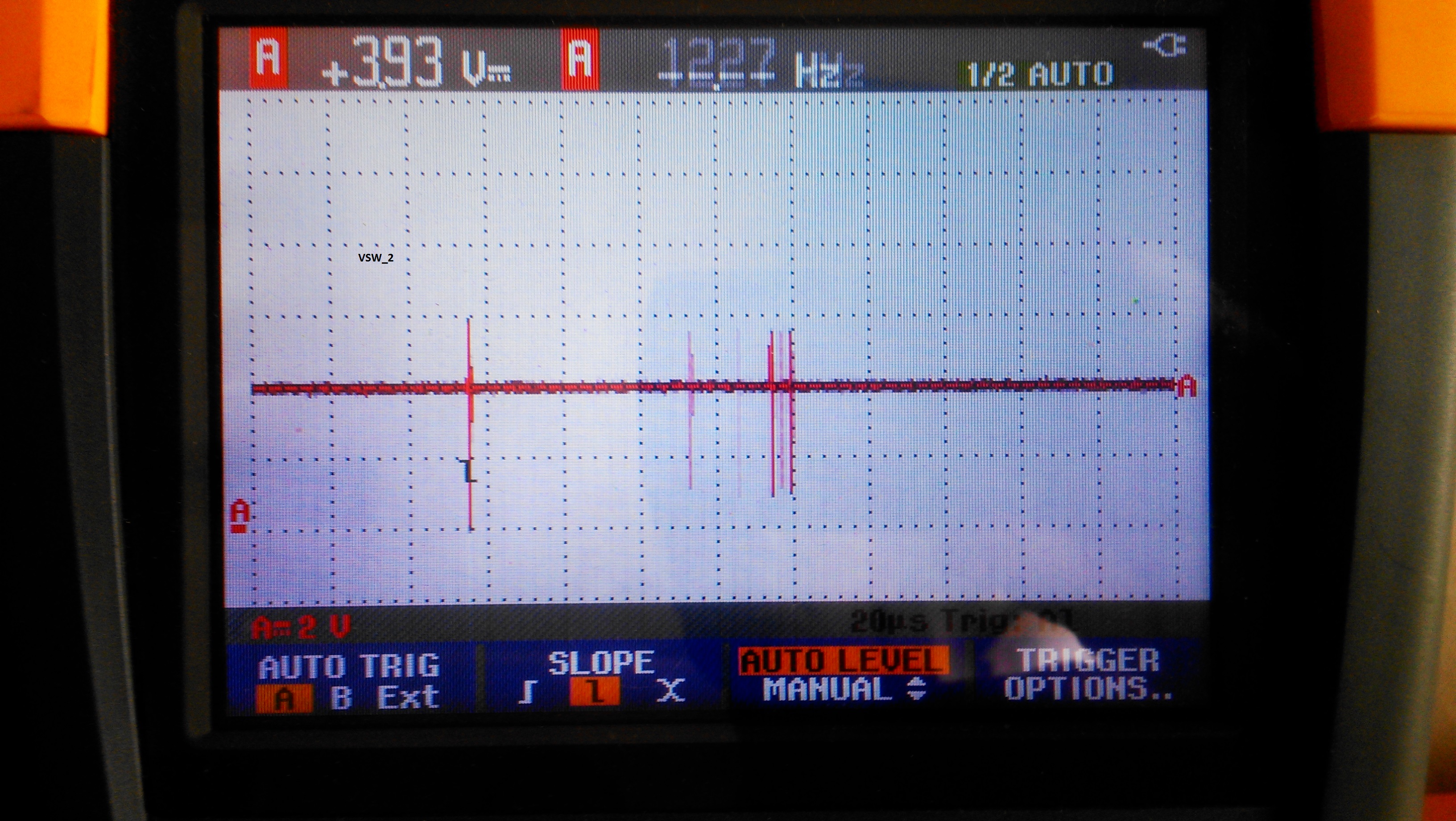

    I have done the new test, and here is what I got. (To begin with the end, it seems like a battery issue, but it also seems to be dependent on the current drawn from SYS):
    - I've put a resistive load on SYS - 24ohms
    First setup: NOKIA BP-5L phone battery (1500mAh,actual voltage 3,9V, as far as I know it doesn't have any protection circuit)
    - connect the battery to BAT - 150mA being drawn from battery
    - connect 5V to IN - nothing being drawn from IN
    - disconnect BAT, 90mA are drawn from IN
    - reconnect BAT - 150mA from BAT only
    - SW waveform doesn't show switching but pulses
    Second (and third )setup: Kokam battery (the one described above, second setup was without protection circuit, third with it , results were the same)
    - connect the battery to BAT - 150 mA are drawn from battery
    - connect 5V to IN - 200mA are drawn from IN, from which 42 are send to the battery
    - remove 5V from IN - 150mA from battery
    - reconnect 5V, remove battery - 160mA are drawn from IN
    - SW waveform looks like you said it should (switching freq at 3MHz)
    I have repeated the second and third setup connecting the battery to the gauge input. Result and values were the same as before (when connected to the IN pin).
    Faze 2: I have changed the load from 24 ohms to 47 ohms, tried all combination of battery with or without  protection and IN or gauge input:
    - connect the battery - 80mA are drawn from it
    - connect the 5V at IN - 80mA from BAT, nothing from IN, SW waveform with pulses(BAT at 3,72V and SYS pins at 3,7V)
    - remove battery - 60mA from IN, SW waveform is switching, 3MHz, SYS at 3,59V
    - reconnect battery - nothing from IN, 80mA from BAT, SW waveform with pulses
    If it is a battery detect issue, it seems it is somehow connected with the current being drawn from SYS (or the internal loop selection algorithm). Considering that my board is using 25mA max (usually below 10mA, and in stand by less then 1mA) that might be a killer issue.
    The battery cables are 10cm long and are pretty thick (can deliver 3,3A DC). The pack is delivered by the producer in a thermo - contractile wrap, with circuit board an wires (I have cut one open to remove the protector). I have tried the Nokia battery and weirdly it doesn't seems to be detected. I don't have any other batteries available, but I might get my hand on a 18650 Chinese soon.
    I think I'll have the PCB remade, and start with a clean one (I don't have any other ideas, and I have already checked all the component values, PCB lines, vias, etc). This one looks pretty messy after all that work done to it.
    Doru
  • Hi Doru,
    sorry for the later reply. I was out of office last week.
    Behavior in  your second case is expected one. With IN on, battery off, you should see square waveforms at both SYS and BAT. They two will follow each other. Can you capture the waveforms for both failing and passing cases? You can debug this according to datasheet 9.3.6, in page 24.
    Linhong

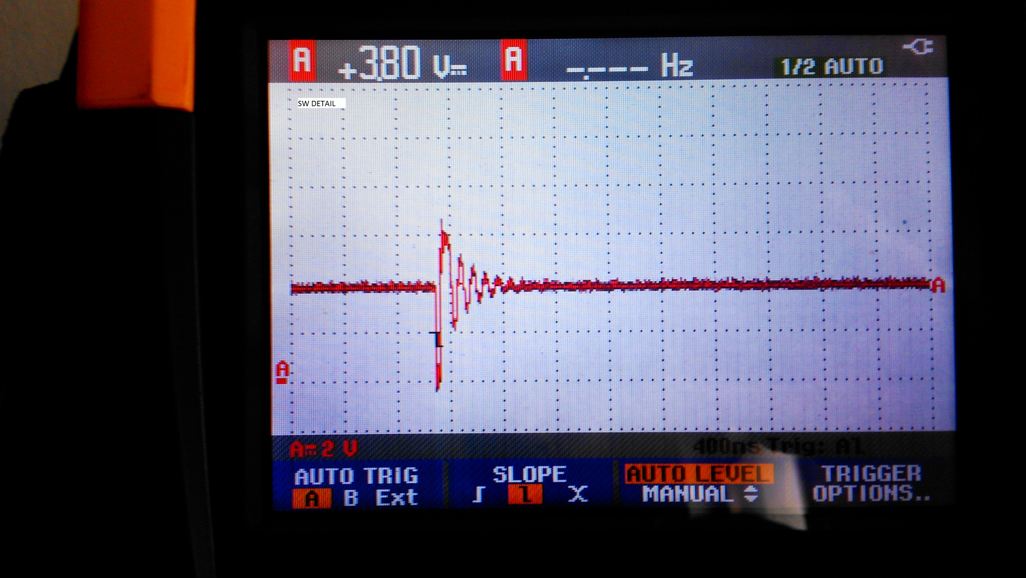

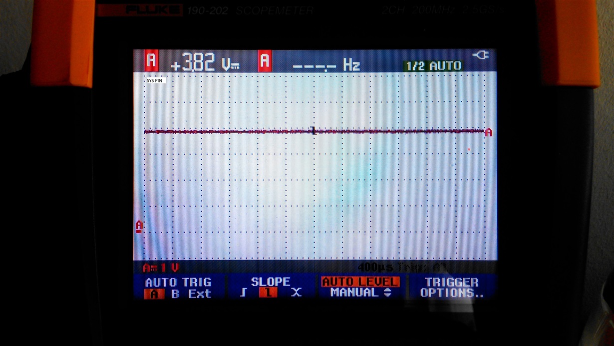

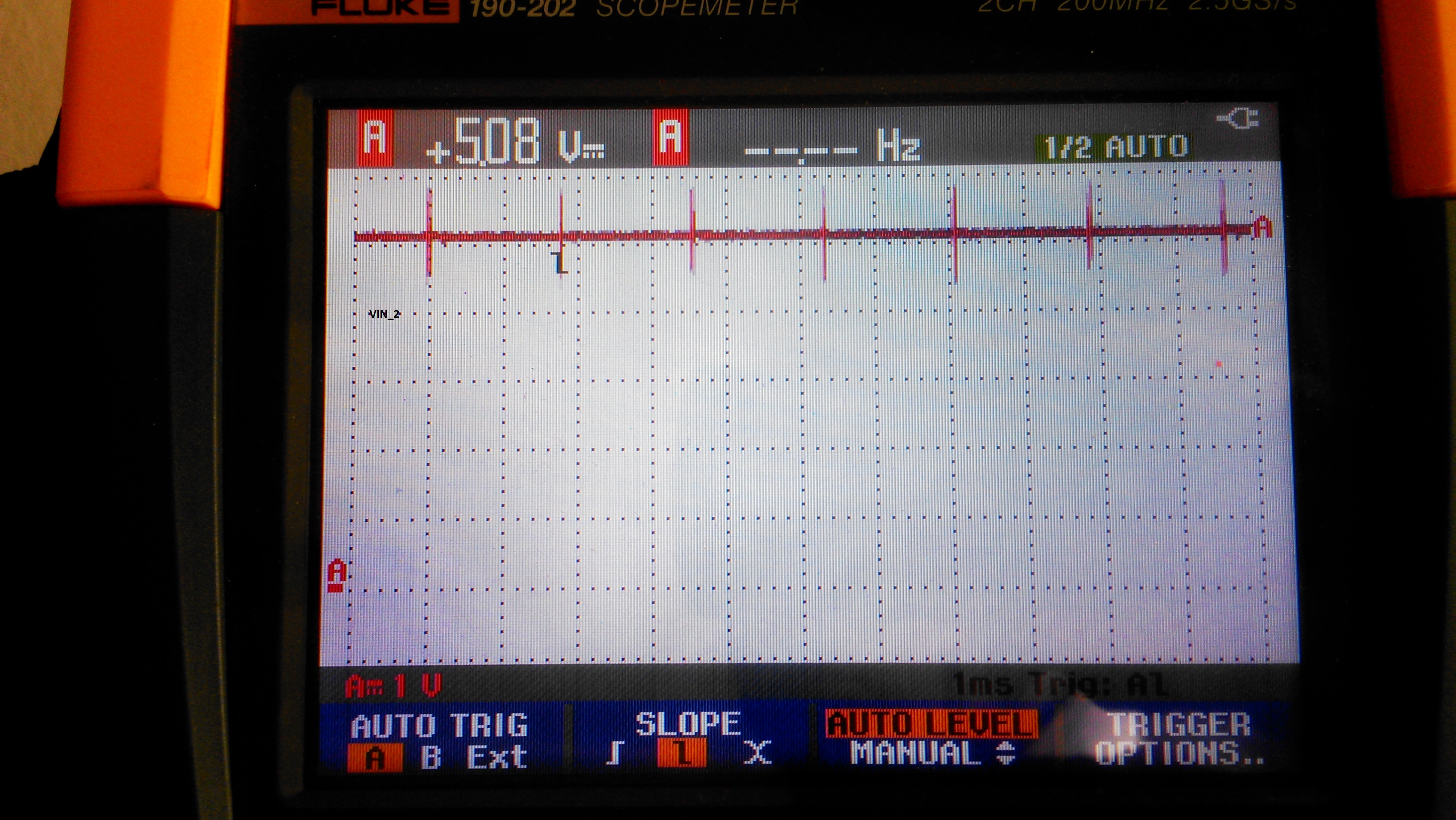

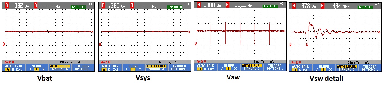

    It took me some time to respond, but I've moved the bq24251 to a new board. I kept only the components in the dotted square, from the schematic attached earlier on the post. D+ and D- were left floating, SDA, SCL, STAT and PG pins were pulled up to Vsys with 10Kohms. As a load I used 47ohms resistor. The rest of the components were left as they were in the schematic. I repeated the test with batteries with and without protector, but the result were identical, so I will put only one set of waveforms. Tu sum it up:
    - battery with Vbatt = 3,83V
    - power source Vin = 5,00V, I=3A
    - load 47 ohms
    1. I connect the battery to BAT pin and the current drawn was 80mA. I didn't take snapshots of the waveform, they were all equal with the battery voltage (Vbat, Vsys, Vsw = 3,82V, no glitches, noise, etc).
    I connected the Vin. The current drawn from IN was 3mA, waveforms attached below.
    As as see it, there are no pulses on Vbat or Vsys, so the battery was detected (I guess in the step where Vbat was checked if it was smaller then 4,08V), but the charge didn't start. (when the processor was on the board, I never got battery error on registry when the battery was connected).
    2. I removed the battery. Current drawn from IN was 67mA, with the following waveforms:

    Now all measurements were made with the battery connected directly to BAT pins. The current of 80mA drawn from the battery was measured at the beginning, with IN disconnected and verified by measuring the voltage across the 47ohms load.
    Every time I connect IN with the battery being connected, Vsys has a glitch like this:
    In the end, reviewing the diagram of AnyBoot Battery detection, it seems like the battery is actually detected. If the system starts from IN, and not from the battery it detects the battery removal too (but still no charging occurs).  When the battery is inserted first, The AnyBoot doesn't seem to work on battery removal. The battery voltage is 3,82V, so it should exit on Vbat < 4,08 condition. I assume there are some triggers for the AnyBoot algorithm to start: power on, In voltage presence, Bat voltage removal.
