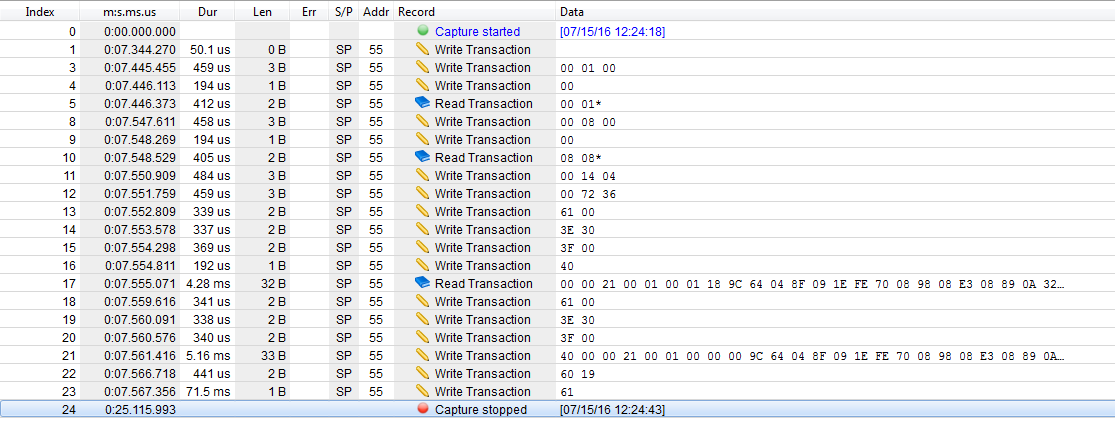

  • I have the same problem at the moment.
    I want to reset the Cycle Count in case the batteries are replaced.
    Reading the 32 bytes works, the data looks correct.
    After writing the changed data back and sending the checksum i want to read the block again and verify the changes.
    But the command after sending the checksum hangs.
    Here is a log from the data analyzer on the I2C bus:
    Is it necessary to wait some time after sending the checksum to let the gas gauge write the data to flash?
    Sebastian
  • I verify that the data is correctly read now by reading the checksum and calculating it over the read data.
    Writing back the data and checksum works too. The gas gauge accepts the changed data.
    bqStudio shows my changes when i read back the data from the gas gauge.
    So i am sure everything is ok with the write command.
    But still the next command (0x61) hangs.

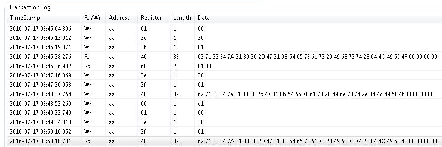

  • I tried a sequence and did not encounter the hanging problem. Please provide the sequence where you had the problem.

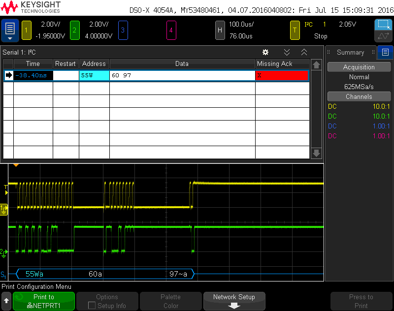

  • We've finally got a development board + EV2300 and the chip works with it.
    However, EV2300 communicates over i2c using a non-standard and extremely slow baudrate ~35 kbps. Indeed that was the key - slowing down the bus, I can make BQ working. But it won't work over 100k or 400k standard bps bus. I would consider this as a bug of  BQ34Z100-G1.
    I have attached two CRO shots, where the checksum is sent from EV2300 at weird rate and then from my CPU (tm4c1290) at a standard 100 kbps rate. You can see that there is no ASK bit in the latest case.
  • I've tried it with a baudrate down to 20k, but after sending the checksum the next command still timed out (longer than 70ms).
    I've added a long delay (1 second) now after sending the checksum and this way writing the dataflash even works with a baudrate of 100k.
    It seems like the gas gauge needs some time writing the data flash and doesn't respond via I2C. I have not found any specification for this in the datasheet. It would be interesting what maximum time one must wait when the gas gauge writes to the data flash until it is ready again.
