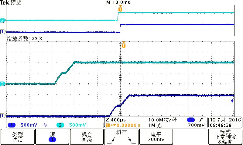

  • Hi Kevin,
    I checked the rails those enabled by SLP_S3B by using the scope and the power  sequence is right. But the VGG and VCC have some glitches during power up. The scope shot is in attach file, the blue one is the VGG, the deep blue one is the VCC. Is this platform during power up OK?
    Kevin Chen
  • Hi Kevin,
    That start up looks correct. We power on to 0.5V, then DVS in a controlled manner to the set VID value. Figure 5-4 shows this behavior.
    Overall this doesn't appear to be a power-related issue, perhaps the BIOS isn't loading properly? Do you see any action on the SOC_I2C0_SCL &
    SOC_I2C0_SDA lines?
