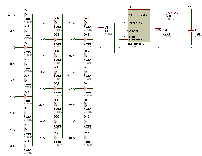

Hi everybody,
I need to do this schematic for my board:
It's possible to have square waveform at my input Vin (0 to 24V). I have any others solutions for supplie my DC/DC regulator. So my question is : what is the reaction of the TL2575HV-05 if i have a low frequence ? Can it accepte a square waveform in input ? What's about time life ? What's the effect on the output ??
I didn't found any informations in the documentation
www.ti.com/.../tl2575hv-05-q1
Except this but there are no informations with this timing.
Thx for reading
Best Regards
Flavien.
  • Hello Flavien,
    I don't believe that there should be any damage to the device as the device will just be turning on and off, but I would not expect that the device would be regulating properly.
    The device requires a DC input to be able to regulate, so with a square wave the device will be regulating and then not regulating in rapid succession based on the duty cycle and frequency of the square wave.
    I would expect there to be a lot of noise on the output of the device because of this on/off cycling of the device.
    Are you using a PWM to vary the brighness of the LEDs and then trying to regulate from this voltage? If you have a source for a 24V PWM, do you not have a 24V DC supply to put on the input of the TL2575HV.
    Michael
  • Hi Michael ! Think you very much for your best answer !!
    For your questions;
    "Are you using a PWM to vary the brighness of the LEDs and then trying to regulate from this voltage?"
    No. Befor my inputs there are switches bring the 24V, so it's like a waveform but I can't change switches.
    I use the DC/DC converter for supply LEDs and take less power that is I would use 24v supply. So if there are noise at the output, I don't think that will be a problem.
    Maybe I can improove the schematic with the On/Off input ??
    Thinks a lot again Michael.
    (Sorry if my Enlish is not perfect, it is early here)
    Flavien
  • Flavien,
    I don't believe the ON/OFF input will help you in this scenario.
    With an input square wave, I am concerned that the output may be varying widely in its output.
    The best case would be to have as close to a DC input to the device as possible, but without being able to do this, I would suggest setting this circuit up and testing it to see what the output voltage looks like.
    Michael
  • Michael,
    Thanks a lot for your answers, after reflection, the probalility to have a waveform in input will be low. So we can suppose that the supply will be DC because I have some LED always on.
    thx a lot again ! You are awsome.
    Flavien.
