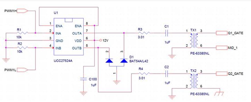

Below is my UCC27524A circuit where the TX1 and TX2 are PE-63385N which is pulse transformer. My question is
when both PWM1H and PWM1L are "H" (12V DC), the OUTA and OUTB does not become "H".
for debugding, we remove R1, R2,  TX1 and TX2,  both PWM1H and PWM1L are set to be "H" (12V DC), but
Any suggestion?
