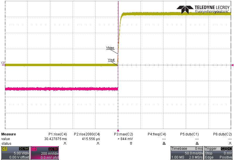

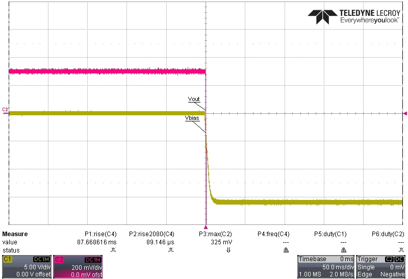

  • Hi Kobayashi-san,
    Both the TPS7A49 and the TPS7A30 are actually able to turn on as long as their output voltages remain within the specified absolute maximums and minimums. Attached are some scope shots. The outputs are at non-zero values at the beginning, but once Vin is high, the output also turns high (The pink is the output, the yellow is the input):
    If you require further assistance, could you provide more information regarding your circuit?
    Yuanhao

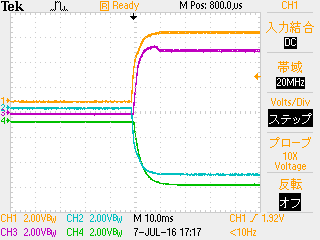

  • Yuanhao-san
    Thank you for your support.
    How was it tested? Is there a load?
    Could you test in the state with the plus or minus load?
    Our waveform is attached.
    The positive and negative voltage starts up the same time mostly.
    But ambient temperature is changed, positive doesn't start thoght the output isn't biased.
    Kobayashi
  • Hi Kobayashi-san,
    I tested the TPS7A49 by applying a bias voltage of -0.3V and a bias current of 10mA, and I tested the TPS7A30 by applying a bias voltage of 0.3V and a bias current of 10mA. A bias of 0.3V was selected as to not exceed the Absolute Maximum ratings of the device.
    These devices are designed, characterized, and tested for operation within the recommended operating conditions stated in the respective datasheet. Exposure beyond the recommended operating may result in performance and reliability degradation. As such care should be taken to design applications within the recommended operating conditions.
