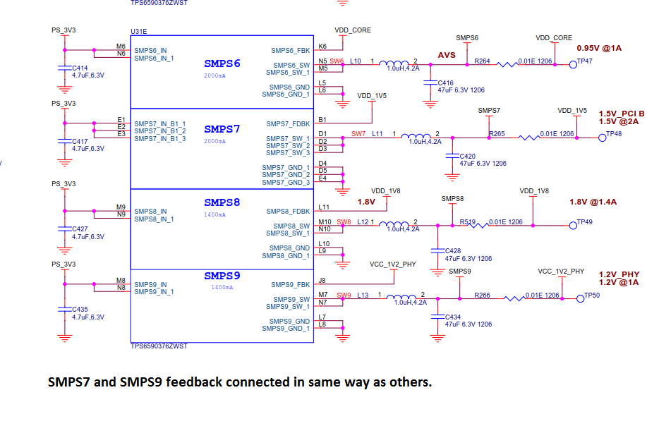

    Now i am facing issue in setting voltage for SMPS7 and SMPS9. I have mounted the PMIC with option 0X7D and getting 0volt default when enabled get 3.3V. However tried setting different values in SMPS7 and SMPS9 register it still give me a output of either 0 or 3.3V. I need  to set 1.5V for SMPS7 and 1.2V for SMPS9.
    Is there any specific setting to set desired voltages? Do i need to follow any sequence. I am able to readback the values from  PMIC whatever is being set in voltage register.

  • Hello Amrendra,
    Would you be willing to share the schematic around SMPS7 or SMPS9 output?  It should be connected the same way as the other outputs.  If you are only getting 0V or 3.3V, you might check that the feedback signal is connected to the output correctly.
    I just checked on my EVM based on this question (maybe the same issue as yours?) and set SMPS7 to 1.5V with the following commands:
    I2C write: I2C address 0x58, register 0x33, data 0x6A
    I2C write: I2C address 0x58, register 0x30, data 0x03
    No other commands are needed, so I think there must be some other issue.
    Karl
  • Yes connection is in same way as other regulator. I can send snapshot of schematics , however don't see an option for attachment. Can you guide me how to send an attachment here.
  • You might have to do "Use rich formatting", and then add attachment. Otherwise you can send my an e-mail using the address in my profile.
    Karl
  • Here goes the attachment
