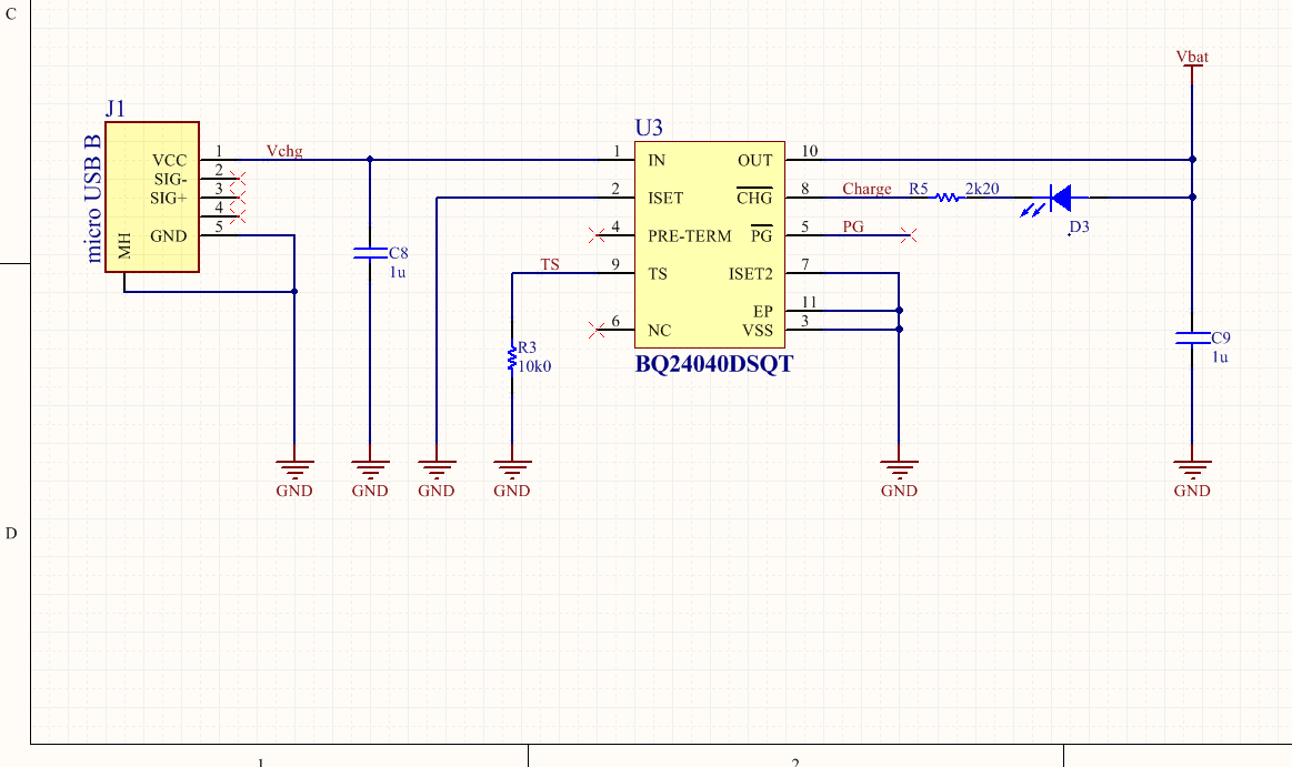

We've got a new design and have sent out for PCBs but in a cost cutting review I made a mistake and eliminated the ISET resistor and shorted it directly to ground. ISET2 is also shorted to ground. Here is my circuit:
The battery we will be connecting is only a 100mAh battery. What would happen if we try to use this circuit? I'm going to try and cut the trace to ground and add an external resistor but I thought I would check to see what would happen if we try to use the circuit like this.
George
  • There is a short circuit detection on ISET pin. If a short is detected on ISET, Iout latches off.
  • That was my understanding as well but I figured it wouldn't hurt to just double check. Thanks for responding!
  • Hello again! I have my boards built and the technician was able to cut the trace from pin 2 to ground. She also added an external 10k resistor from pin 2 to ground. I verified that pin 2 is not shorted to ground by checking the resistance from pin 2 to ground and I measure 9.8k ohms.

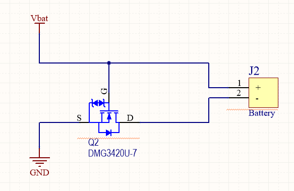

    I have a protection FET on the battery ground line but that shouldn't be an issue since the voltage regulator that's on the board works (as well as the other components) when I'm powered by the battery alone.

  • 10k resistor between ISET and GND will program the fast charge current to around 50mA.
    If the IC gets hot when the current is only 2mA, then there is definitely a short somewhere. Can you use a multimeter to measure the continuity of each pin on bq24040?
    Please also try to remove the protection circuit and connect the battery directly to the OUT pin.
    Measure if it is 5V at IN pin of the IC.
    Make sure TS voltage is within the normal temperature range.
    These are what I can think of based on the information you have provided. I would also suggest to replace the IC on the board that has the hot issue.

    I don't have the ability to remove the protection FET but the switching regulator on this board is working so I don't think that could be a potential problem.
  • What would happen if ISET is shorted to Vin? When the technician added the 10k external resistor from ISET to GND I think there is a short under this resistor between pins 1 and 2. If I measure pin 2 I see 5.1V which is Vin. What would the BQ24040 do if ISET is Vin?
  • At input source plug in, there might be a large ring voltage on connection due to the parasitic inductance. This ring voltage might get higher than the maximum voltage rating on ISET. If ISET is shorted to IN, then ISET might get damaged.
  • What would happen if ISET did not get damaged but is at Vin=5.1V
  • If ISET is not damaged, then there should be no charge to the output.
  • OK, thanks for letting me know that. I'll have to check the boards next week but that would at least explain why they don't seem to be charging but all of the charger functions appear to be working. Kind of ironic that I started with ISET shorted to ground and now to Vin!
