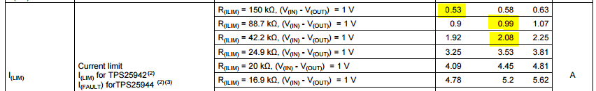

I need one universal eFuse for 0,5A/1,0A/2,0A.
As described in datasheet, TPS25921A can be used for 0,4A-1,6A protection. This is ok for the first two applications.
But for the 2A I need something like TPS25927.
The problem is that i need one chip for the all 3 currents.
Can I adjust TPS25921A for the 2A usage? Maybe with some loss of current limit accuracy or another operating temperature range.  How can I do this?
