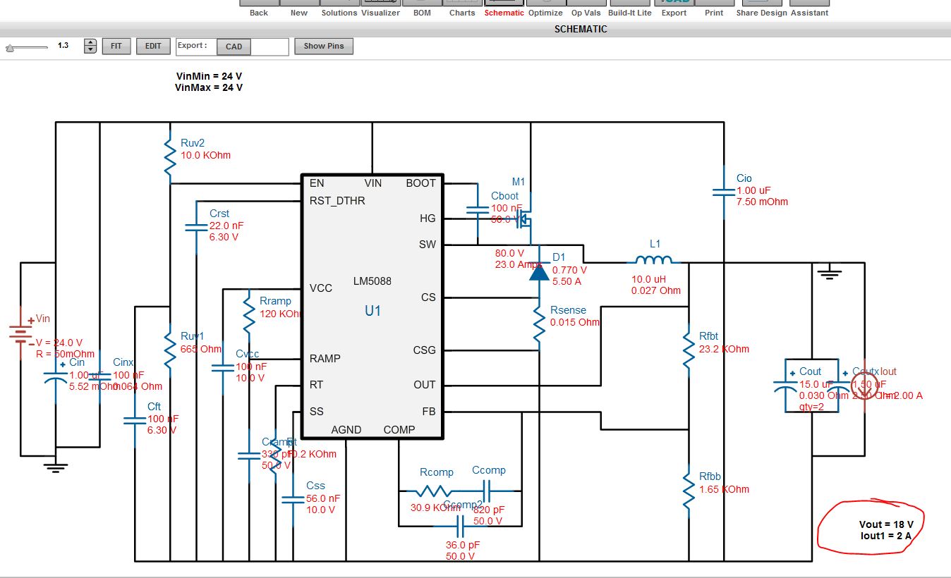

Why can't I reach 3A nominal current on this design ? Components around looks to be strong enough:
In fact, I need a Vout = -18V from a Vin = 24V for a 3A current.

I don't know if it works at 2A, only simulation for the moment but I found the solution durint the night ;-)
To reach 3A I need to increase the input voltage to 26V, change L1 for a 8U2 and also change compensation values and output capacitor.
