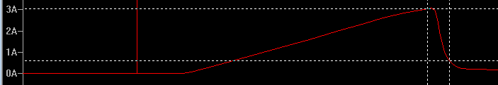

    I have one concern regarding inrush current
    With 470uf the capacitor is drawing 3A for 500us with is flowing through device ,but the device is rated for 1.5A Max will it create problem to device?
    I have attached a waveform for your reference

  • I agree that datasheet indicates that the short circuit current should be less than ~1.6A. Usually this parameter is measured after the device is powered-up.
    If this ramp starts right when Vin is first applied this might be due to the time needed for the internal control circuit for current limit to get biased-up and operating.
    It's not ideal, but I doubt that the device will be damaged.
