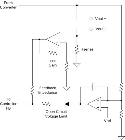

  • Here is the circuit for the feedback of a constant current supply (Generated by a constant voltage across a fixed resistor) with Open Circuit Protection limit.
    The OCV limit is imposed by an integrating amplifier monitoring a reference voltage and the output voltage.  If the scaled output voltage exceeds the reference voltage, the amplifier raises its input, forcing current into the feedback node and reducing the voltage required across the series sense resistor and thus the regulated current.  The resistors are sized such that the integrating amplifier can maintain the reference voltage on the FB pin even if the voltage drop across the Rsense resistor is zero, allowing the OCV circuit to completely shut down the ouptut current.
    The blocking diode prevents the integrating amplifier from from sinking current from the feedback pin, which would increase the regulated current and defeat the purpose of the circuit.
    The OCV circuit is selected for the outer loop because it is by necessity slower than the inner loop and accurate regulation of the terminal current is more important than tight regulation of the open circuit voltage.
