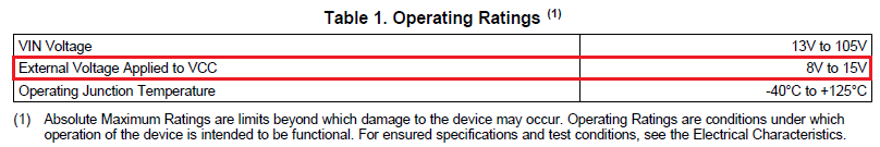

My customer considers applying external DC bias to both VCC and VIN for LM5035C.
In this case, Operating Ratings shows 8V(min) in page 5 of datasheet.
On the other hand, it is required more than 8.3V in page 11 of datasheet.
Which is the correct value?

  • Hi Yaita-san,
    The 8V value is a recommended minimum value and does not represent the value of Vcc necessary to exceed the UVLO threhold. I would follow the figure in the text on page 11 or 8.3V.
    I would agree that the value is not very well explained in the datasheet.

  • Hi Yaita-san,
    The LM5025A datasheet states that the the internal regulator will be turned off when the voltage level on the Vcc pin is at 8V.
    This winding must raise the VCC voltage above 8V to shut off the internal start-up regulator.
    The LM5027A appears to have a different implementation. The outputs and reference are enabled when Vcc reaches 9.5V, the regulation value. To turn off the internal regulator the bias voltage from the auxiliary winding must be raise the pin voltage over the regulation voltage which drops from 9.5V to 7.5V after the first SR pulse is produced.
