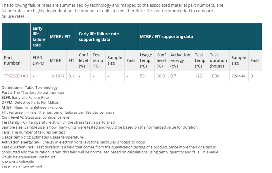

    2. What is TPS25921 life time by design with no TSD working? Our customer life time target is 13 years.
        Can the device meet the life time target?
    [VN] Here is the reliability data link http://www.ti.com/quality/docs/estimator.tsp?OPN=TPS25921AD&partNumber=TPS25921AD&partType=tiPartNumber#resultstable

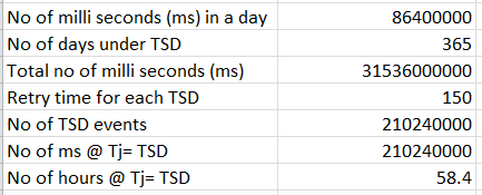

  • Hi Nakai-san,
    Reliability change depends upon no of hours junction is operated at TSD temperature (155degC Typ). If the output is shorted to ground, with 12V Vin and 1A current limit, the device dissipates 12W and enters thermal shutdown in 1ms time. After entering thermal shutdown, it takes 150ms to cool down the junction and re-try again.
    Based on above conditions, if we assume that short persists for 365 days, no of hours junction operates at TSD temp is only 58. Reliability change for such small no of hours of operation at TSD temp is minimal.
    Venkat
