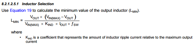

Could you tell me about TPS54335A inductor selection?
About the Lmin calculate , from the datasheet it is calculate as follows:
About the Iout parameter, did it mean the normal operation current ?
Or it is means the maximum current?
For example, in the follows design, the 12.4V maximum current is 790mA,
But the normal operation current is only 48.7mA,if we use the 48.7mA for Iout
,the inductor should be at least 356Uh,I think it is not right.
Could you tell me your advice?
