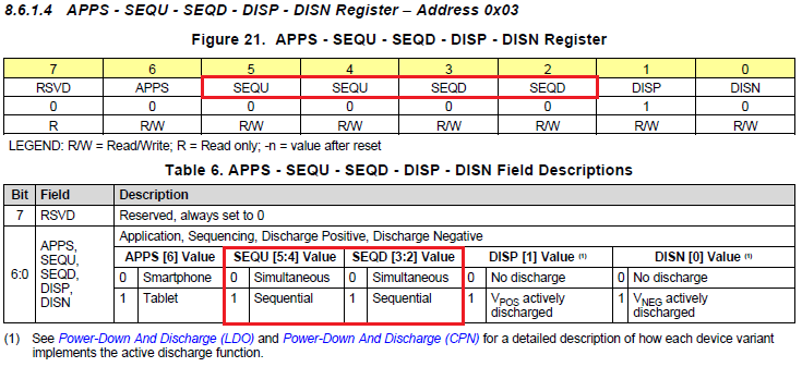

I believe enable timing of Vpos and Vneg can be set independently by ENP pin and ENN pin.
Are SEQU and SEQD applicable for TPS65132B?
I believe SEQU and SEQD are only applicable for TPS65132S because it has EN pin only.
Is my understanding correct?
