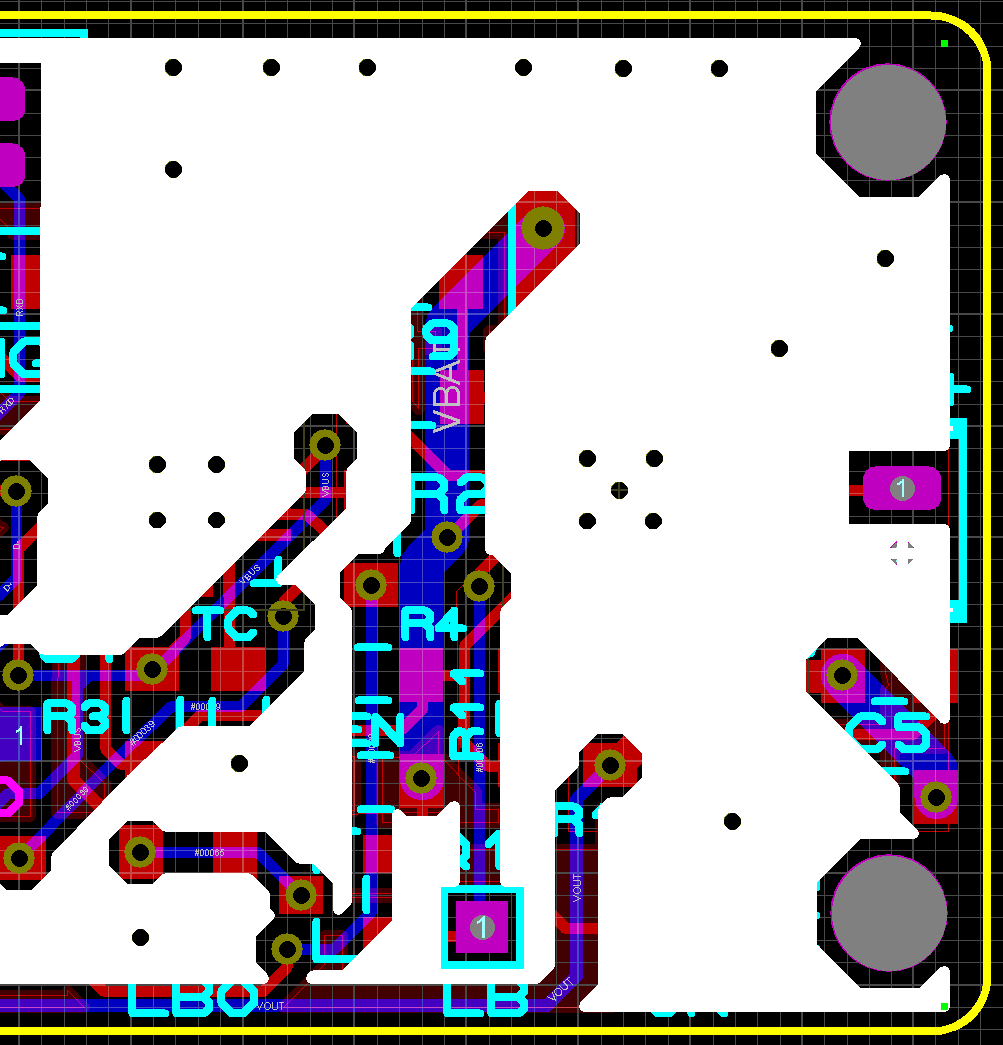

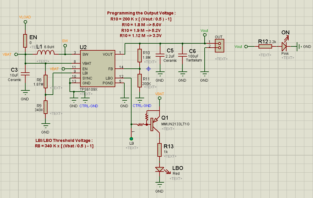

I am using a TPS6109 to boost to 5V from a 3.7V li-ion battery. My problem is that even with the TPS enable pulled high, the chip is not converting voltage.  I have attached schematic and board layout.  Any ideas what could be causing this?

    i don't see problem in the schematic, but the layout is really bad. please refer to the datasheet page 19 and the application note "SLVA773" to modify the layout

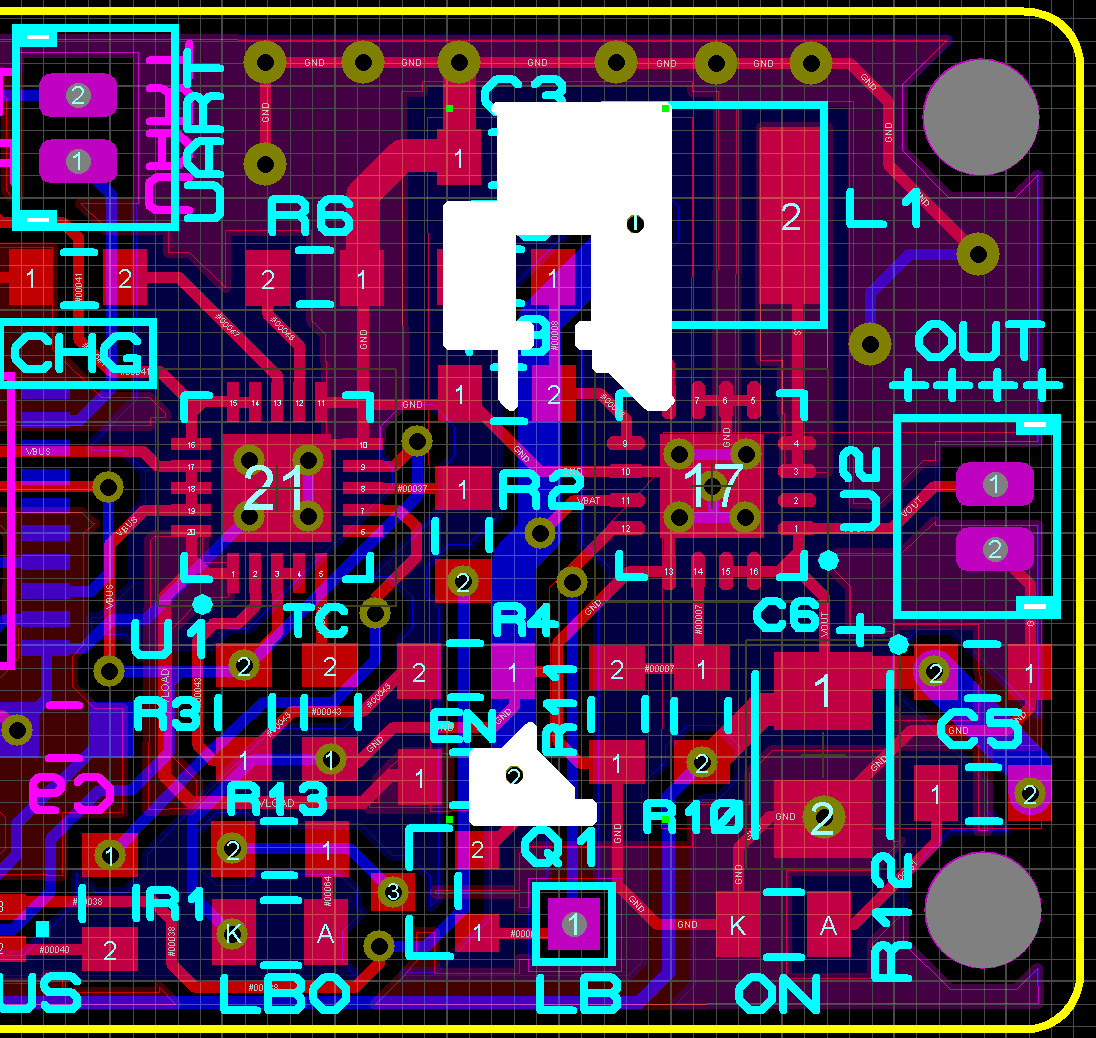

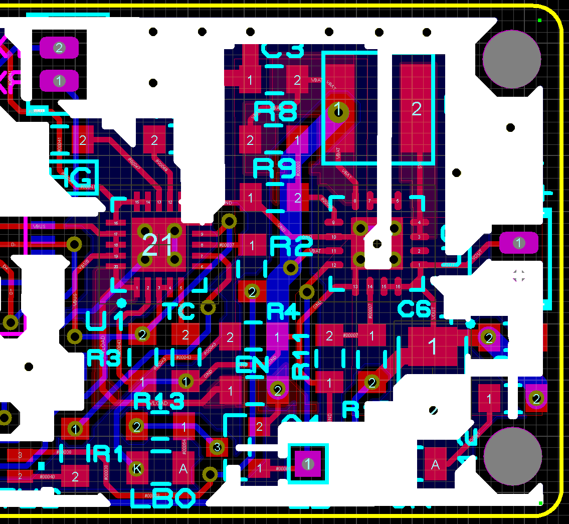

    Here is our PCB with highlighted different parts of : TOP Ground Plane, Bottom Ground Plane, SW Plane and VBAT plane
    PCB
    TOP Ground Plane

  • The layout is not good. there is risk that the device could get damage in heavy load condition.

  • The output ceramic capacitor should be placed closed to the IC, and the routing should be short. refer to datasheet page 19 and the application note "SLVA773". following are some steps to debug the problem

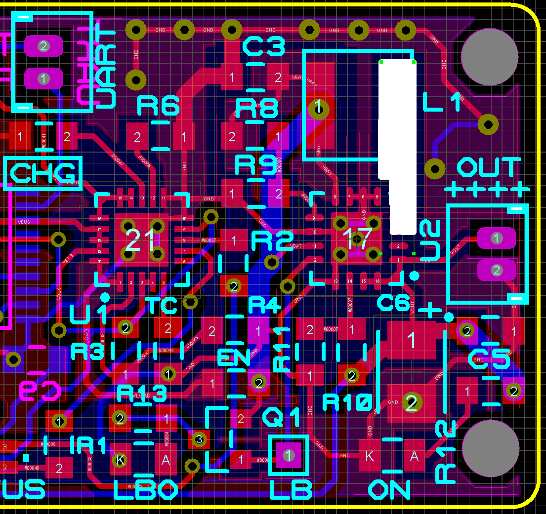

    We build a new PCB and took care about advices you provided.
    Result is exactly the same, the output voltage turns down to 3.4V again after 5 seconds instead of sourcing 5V.
    The devices gets also very hot, it looks the temperature security is applied to secure it.
    * Could C6 be tantalium capacitor or must be ceramic ?
    - When we use 100uF tantalium capacitor for our tests, output voltage falls down after few seconds after the board power-up.
    - If we use 100uF ceramic capacitor, the voltage goes immediately at ~3.4V after the board power-up.

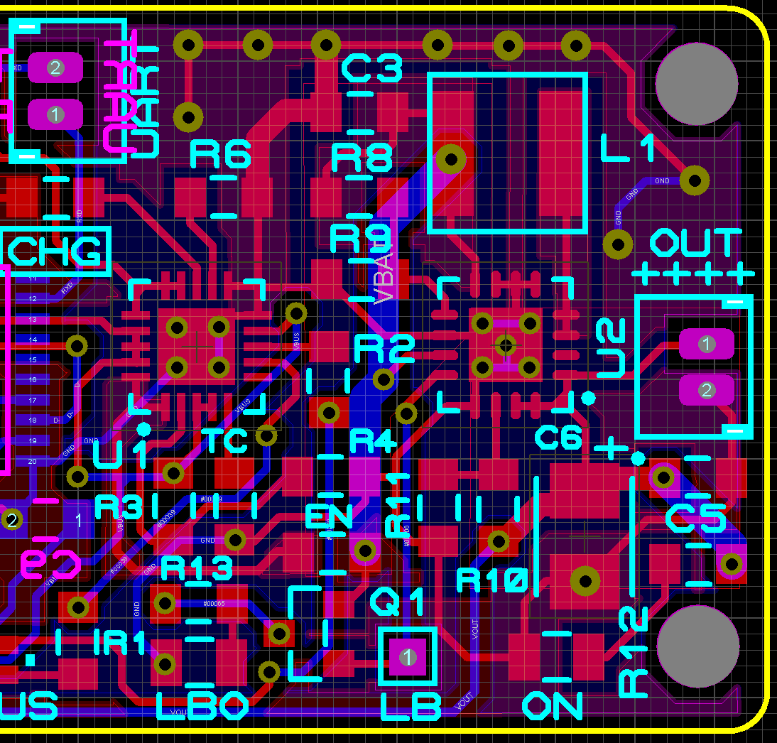

    Here is our latest PCB :
  • i still see problem in your layout, have you refer to the "SLVA773" to build the layout? i am think if i can make an TPS61090 pcb layout example for you.
