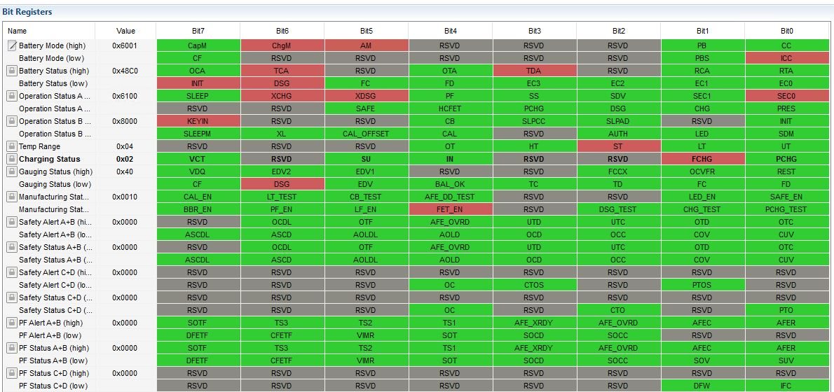

I have connected the BQ76940EVM to a battery pack.
my XDSG and XCHG flags a permanently on.
I programmed the default firmware of BQ78350-R1, and defined all "Data Memory" parameters.
I send FET_EN command (while in unseal) and I can see the flag is set.
I cannot see any fault or protection flag, "toggle DSG/CHG/PCHG" is not responding in unseal full access mode.
I connected only the BQ76940 to I2C and cleared all faults from GUI.
I re- programmed to default, and imported GG.CSV file and it did not help.
I cleared PF events, did not help.
CHG FET GATE is 17V, DSG FET GATE is ~0V regardless ov Keyin.
