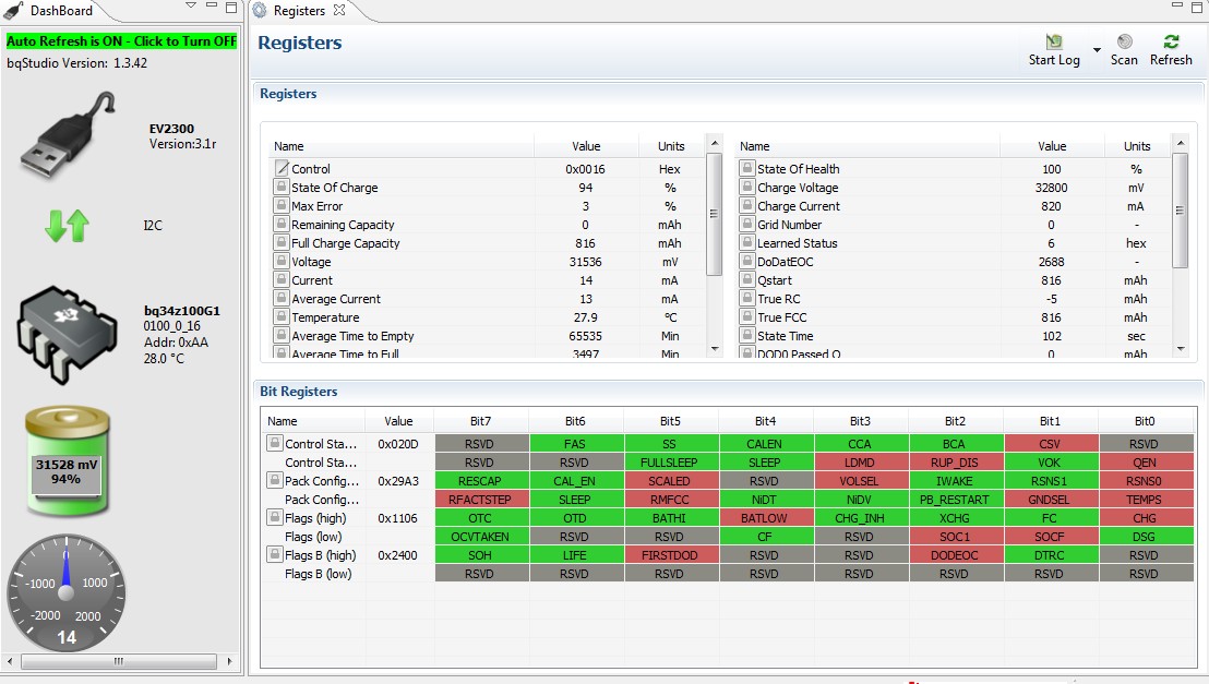

We have problem to do the calibration to bq34z100-g1.
After we calibrate the Board offset and CC offset to the bq34 (by Battery Management Studio), the report value of current ISN’T “zero”, but a tiny value, eg, 10mA.
Our production line has been stop by this issue, appreciate if you could share us some idea about this.

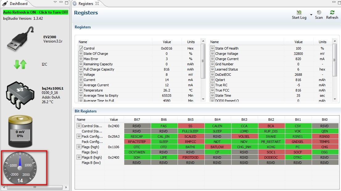

    i do the test as your suggestion, calibrate the voltage first and then calibrate the curren offset. but the same phenomenon occur, the curren is still NOT "0".
  • You should complete the calibration before sending the IT_ENABLE, because the gauge limits changes after IT is enabled. If you cannot calibrated out the error, then there must be something in the external components or layout that is introducing an offset that the gauge cannot compensate. Do you see this on all of your boards? I also see that the GNDSEL flag is set. It should be set, if your VSS connection is to the PACK- side of the sense resistor. It should be set to 0, if your VSS connection is on the BAT- side of the sense resistor. You can also try manually entering Board Offset values to see if you can force the current to zero. this may tell you whether gauge has enough range to calibrate the error.

    some units can be "zero current" by modify the Board Offset value, and these unit is also can been calibrate to "zero current". The others, who can't be calibrated to "zero current", also can't be "zero current" by manually entering Board offset values.
    for more, it look like that the CC offset can't be modified by manually entering a value, is there something wrong with my operation?
    and no matter the "good unit" or "bad unit", after calibrating the curren offset, the value of their CC offset is about "-14xx".
