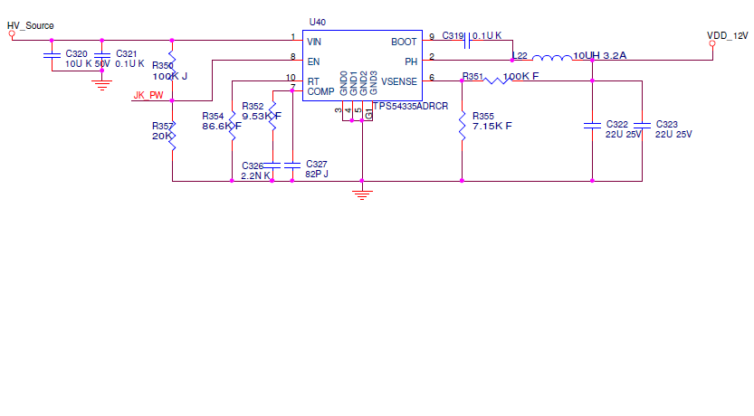

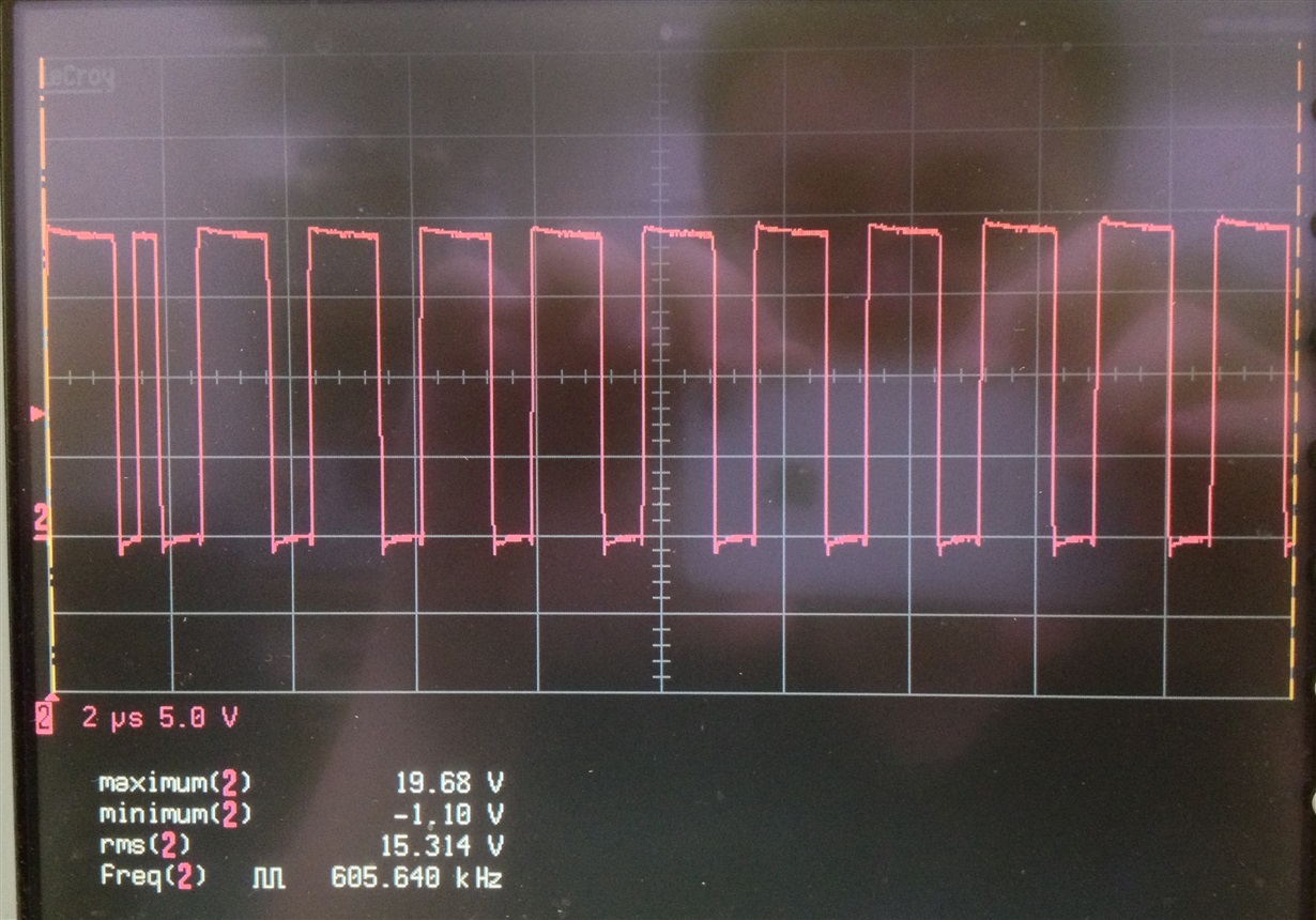

Dear Team:
 Our customer used TPS54335A and got a strange PWM waveform (add a puls ) as attached file, when load =1A.
Because TPS54335A is current mode, it should fix PWM frequency. Circuit design: VIn=20V, Vout=12V, Iout(max)=3A
Could you explain the symptom?
