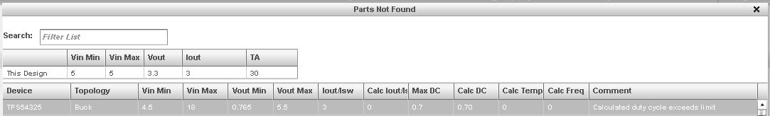

My customer have a question about webench.
It can not be set by the condition of the Vin:5V,Vout:5V,Iout:3A by webench.
Looking at the "show why parts were not found".
It is written with the "Calculated duty cycle exceeds limit" to comment.
Although Max DC has been written with the 0.7,
the data on the sheet is going to be if there is Toff time more than 0.195%.
(1/750kHz(fsw)=1.333us     260ns(toff(min))/1.333us=0.195)
Why is Max DC is in the 0.7?
