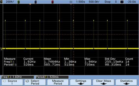

According to bq40z50-R1 TRM, the device takes voltage, current, and temperature readings every 250 ms. I am trying to measure TS1 pin to check the behavior. The result is shown as attachment. Based on the result, the sampling interval is not stable (~500ms or ~750 ms). Please kindly clarify it.
