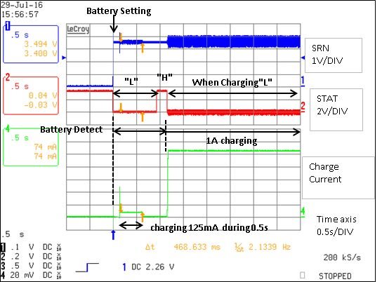

Please let me confirm STAT Timing.
Following is the waveform when battery setting.
STAT is "L" when the battery is detected, and STAT is "H" after about 1sec.
Is there any specification about this timing that STAT becomes "H" ?
