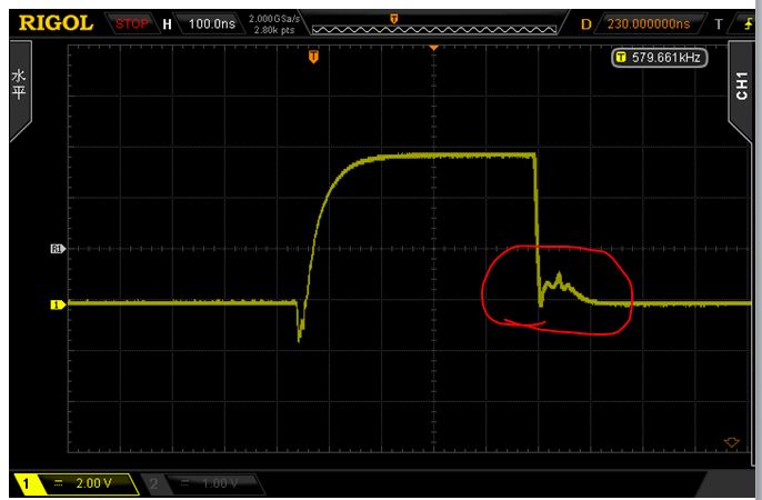

BQ24610 LODRV waveform
Other Parts Discussed in Thread: BQ24610
Hi team,
My customer is using the BQ24610 now. We find the LODRV will rise up again when the mosfet turn off. It may cause the low side mosfet turn on again. It should be caused by the Vds change. Vds influences the Cgd to cause the Vgs change. We see the datasheet also has the bump. Could you please help check it?
Thank you.
