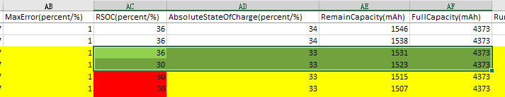

1. Below show one of the BQ20Z75 project test, RC and FCC doesn’t have a big change but Why RSOC jumps? And ASOC has update correct? RSOC= RM x 100/FCC, but Qmax, FCC and RM don't change a lot.
2. In another project, customer test the pack by discharging it to 5% SOC and relax for one night. During  the relax the SOC will jump from 5% to 11%. There are not related registers setting like BQ40z50, Is it still possible to decrease or smooth the SOC jump for this old gauge - BQ20Z75?
