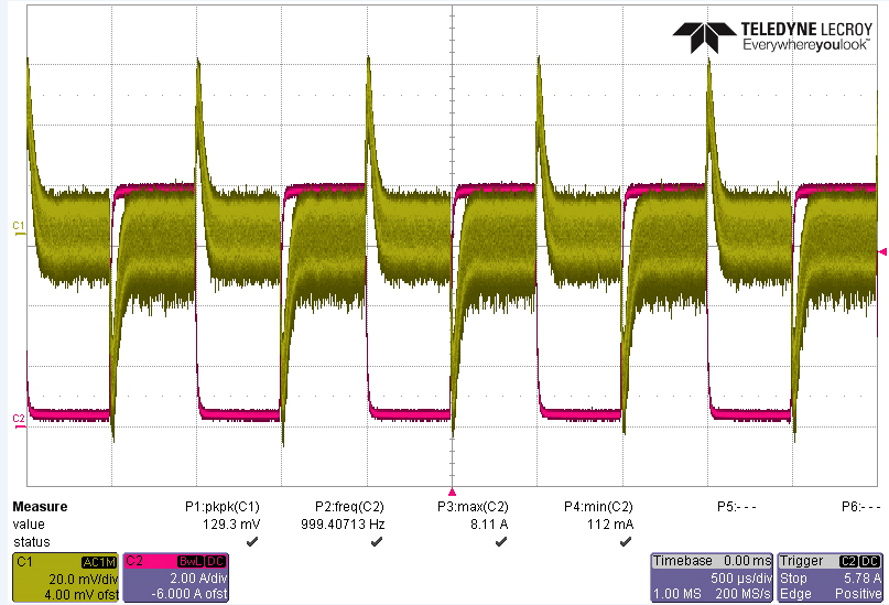

My customer are designing the 8A solution with TPS54821 from 12V to 1V, they had test with EVB with DCC mode (60% load to 120% load, 60% load with 500uS, 120% load with 500uS), the ripple noise cannot reduce to 50mV, even we added couple huge MLCC.
We use the EVM to do the test.
Can you please give some suggestions on this?
