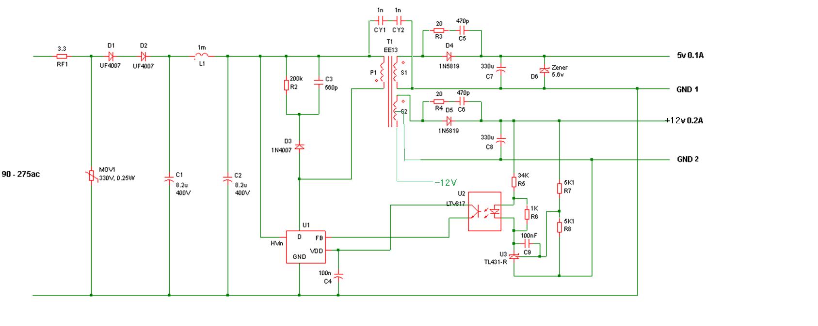

  • Hi Bernard,
    Customer has finished the schematic and transformer design. Could you please help to take a look and give some advise for optimisation? Thank you very much.
    Spec:
    1. Universal input
    2. Output 1 non isolation 5V 0.1A (no feedback control)
    3. Output 2 isolation 12V 0.2A (with feedback control)
    4. Output 3 isolation -12V
    Schematic:
    Transformer spec:5v 0.1A, 5v 0.2A TRF.PDF
    Please note that the transformer winding N3=S2 will change to 48T with center tap.
    Thanks and best regards,
    Victor
  • Victor,
    For half-wave rectification with 16-uF bulk cap, I estimate that the minimum bulk cap ripple will be about 70 V. So the transformer needs to be designed for this minimum input voltage at 45% Dmax (w.c. min). This means that the reflected voltage will be limited to about 57 V. This means the transformer turns ratio from prim to main 12-V winding should be about 4.6:1, but the customer design is actually 8:1 right now. They need to change the turns ratio, or increase bulk cap min voltage level.
    If the customer wants to keep ~100 V reflected voltage, then they will need to change to full-wave rectified, and probably also increase the bulk cap value to about 27 uF. If they keep half-wave rectified input, they will need at least about 33 uF to keep min bulk cap voiltage above 100 V.
    The transformer magnetising inductance is too high, this will not be able to ramp the current up to the required peak value.
    Following the calculation method on page 8 of TIDA-00708 design document, assume Pin = 5 W (3 W output @ 60% eff w.c.).
    At 70 V min bulk voltage, Iin_avg = Pin/Vmin = 5/70 = 71 mA.
    Iin_pk = (Iin_avg * 2) / Dmax = (71 mA * 2) / 45% = 317 mA - the UCC28881 Ipk w.c. min is 315 mA, so we can just about meet the 5-W input power required.
    Lpri = (Vmin * Dmax) / (Ipk * fmax) = (70 * 0.45) / (0.315 * 52 kHz) = 1.92 mH
    On the sch, here are some points:
    - the -12 V rail will need a rectifier and cap
    - what is the load on the -12 V rail? I have assumed total outptu power ~ 3 W max.
    - a pull-down resistor Rfb should be added to FB pin
    - a filter cap option should be added in parallel with Rfb in case it is needed later
    - R7/R8 values are not correct for 12-V output
    - R5 value need to be calculated together with Rfb value to set 1-V level at FB pin. With R5 = 34k, max TL431 current ~250 uA. Assume opto w.c. min CTR ~ 25% => Ifb ~ 62 uA. Vfb ~ 1.1 V = > Rfb ~ 18 k
    - D5 (and diode for -12 V rail) need to have higher voltage rating. For Nps = 4.6, Vmax across diode ~ 400/4.6 + 12 = 99 V => use 150-V diode. For Nps = 8, even higher rating is needed
    Bernard

  • Victor,
    If the customer increases the bulk cap value to ensure that Vmin >= 100 V, then the turns ratio 8:1 can be used.
    If the Dmax of 45% is used at Vmin = 100 V, this gives Ipk ~ 222 mA, then Lpri ~ 3.9 mH as you also calculated above.
    Your calculation of the required turns is incorrect - inductance scales with turns-squared, so the ratio of turns will be the square-root of ratio of inductance:
    L1/L2 = (N1^2 / N2^2) = (N1/N2)^2 => N1/N2 = (L1/L2)^0.5 = > N2 = 192 / (6.6/3.9)^0.5 = 148
    However, this may not be the correct approach since the peak current is also changed.
    It's better to explicitly verify the peak flux-density in the core, Bpk.
    The drawing say that EE13 core set is used, but the Ae and core dimensions are not listed. Is this E13/6/6 or E13/7/4 size that is used? Because they have different Ae values.
    The required turns will really depend on the target Bpk level in the core, which depedns on the customer spec/preference.
    Bpk = (L * Ipk) / (N * Ae) => N = (L * Ipk) / (Ae * Bpk)
    In this case, if Ae = 20 mm^2 (E13/6/6), and if Bpk ~0.3 T (for inductors and flyback transformers, often the Bpk is pushed a bit higher to minimise turns and Cu loss):
    N1 = (3.9 mH * 0.222 A) / (20 u * 0.3) = 144
    => N2 =7 or 8 , N3 = 18+18 (36 with centre-tap) - will need to adjust turns to get closer to exact 12/5 ratio between N3/N2.
    For rating of D5 and diode on -12-V rail, 100-V rating would be needed with 8:1 turns ratio - the 1N5819 part on the sch is only 40-V rating.
