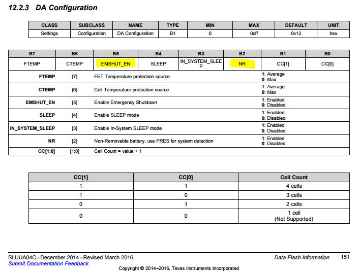

    Did you set [NR] and [EMSHUT] to 1 in bqStudio "Data Memory" tab >> "Setting" >> "DA Configuration" when testing button key press emergency shutdown as mentioned in section 5.4.4.1?
    5.4.4.1 Enter Emergency Shutdown through SHUTDN When a high-to-low transition on the SHUTDN pin is detected with a debounce delay of about 1 s for the low-level threshold, the gauge will turn off both CHG and DSG FETs immediately. This entry method only applies if [NR] = 1 and DA Configuration[EMSHUT] = 1. If [NR] = 0, the SHUTDN pin will restore to the regular system present detection.

    The codes 0z2706 and 0z043d are correct for the bq40z60 device. there cannot be any SMBus activity during the process and that commands must be sent with in 4s of one another. You also must have the EMSHUT_EN and NR bits set in the DA Configuration register and pin 15 open on the device. Some customers have also found that send the two commands too quickly causes it to fail. Try leaving a 500ms gap between the two commands.
