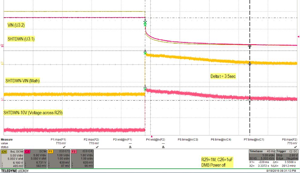

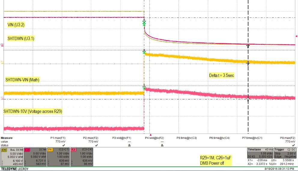

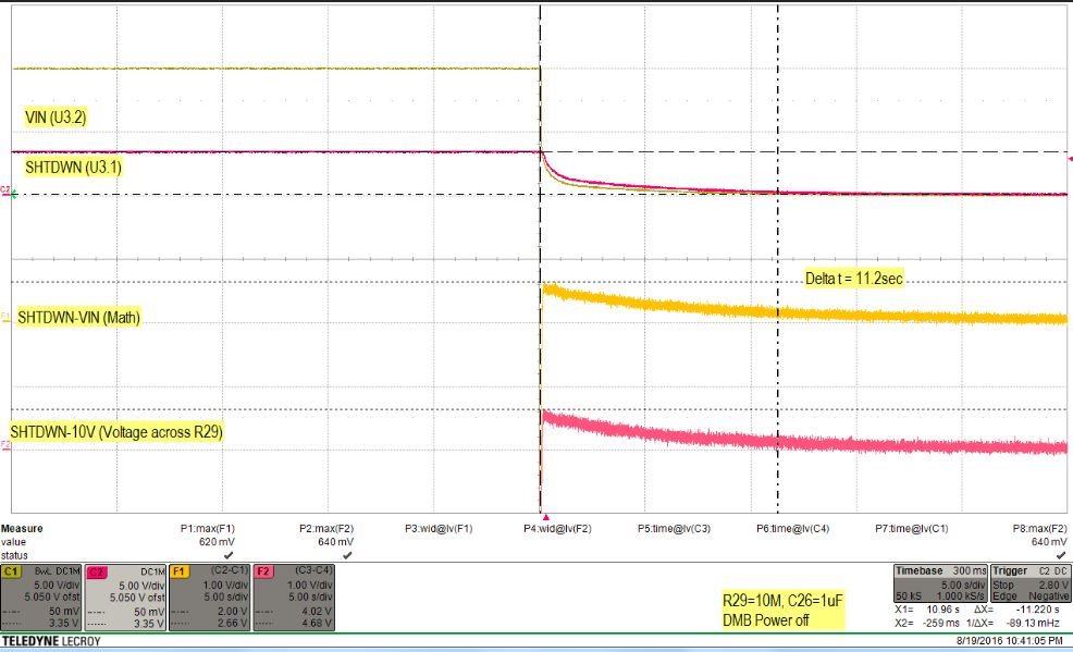

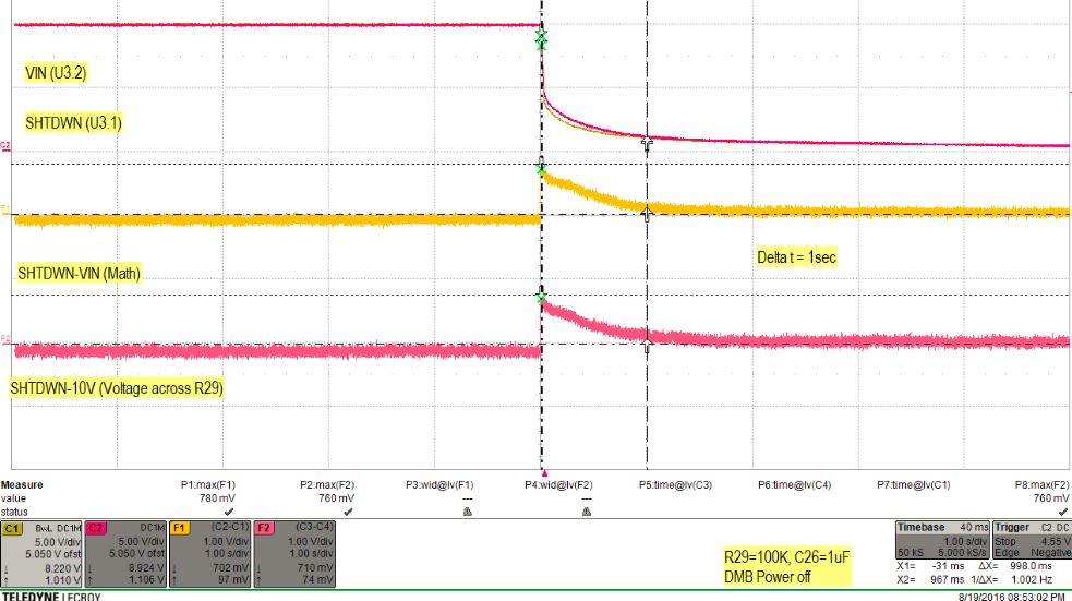

  • Hi Brian,
    A small update. We retained C26 @ 1uF as per schematic that was shared last time, but we varied R29 to 1K, 100K, 1M & 10M....What we observed was that discharge time for C26 from SHTDWN pin (during power-off sequence) was incremental with R29.....That means to say, Most of the energy on the cap C26 was discharging through R29 rather than through SHTDWN pin of IC. This could be because of very high input impedance on SHTDWN pin, which will not allow much energy to dissipate through SPL IC. Also the max voltage difference between VIN & SHTDWN is 0.7V. (could this be diode action?)
    (we do not have option to modify PCB, hence we are trying possible options. We will surely consider your previous suggestion of diode in future)
    Please go through below waveforms.
    With this can we say that energy dissipated into SPL IC through C26 is minimal and is discharged through external resistor R29 to 10V rail ?
    Will it be possible to provide input impedance of SHTDWN pin & max energy or current that can be handled by internal diode on SHTDWN pin (As per your previous post) ?
    Thankyou for your time on supporting us.
    Can you share us your contact info, if possible?  So that we shall have a meeting to understand better on this issue, rather than sharing details through post.
  • Prakesh,UCC3915 Evaluation board slua187.pdf
    The leading edge of the pull down of Vshtdwn is an area to look into carefull.  With 1 to 5 seconds/division resolution, little info is shown on the plots in this region.  Vshtdwn looks to pull rapidly with Vin as the diode between the 2 pins is conducting/clamping, much faster than the RC TC of R29/C26.  Then it appears POR on downstream devices shut reduces the load current and dramaticaly slows the Vin decay from what ever bulk capacitance is present and the difference between the two pins is related to the 100ms and 1 sec RC TC and the final decay of Vin.
    1)  Recommend you put a current probe between the 2 pins and measure the actual current being conducted between SHTDWN and Vin.  Measure the leading edge and the sustained portions.
    2)  If Vin were shorted, the peak current from the capacitor would be high.  In the scope shot, it looks as though Vin is simply shutdown.  I don't know if this is a concern or not, but a shorted Vin would place high energy over a very short time on the diode.
    3) Normal input impedance of the SHTDWN pin is very high as it will draw 0.5uA at 12v.  However, once Vshutdown > Vin, the data sheet violation noted as your concern, then the protection diode will conduct with low resulting impedance.  This is an ESD device that is intended for low energy human body discharge, not sustained currents.  If the current probe measurement exceeds 100mA peak, a latch up conditon can occur.  If ~ 10mA sustained (untested duration of 'sustained') then diode failure may be possible. Either way, this still violates the DS specficaiton and cannot be supported by TI but is provided for your use and risk assessment.
    4) My recommendation would be to bite the bullet and relayout the pcb with the recommendations noted earlier in the email. If you have units built, I would tack on the components to the existing circuit board, ugly as it is.
    5) See attached evaluation board.  I don't think it is manufactured still, it was a late 1990's design.  The Shutdown cap is 0.01uF and I'm sure this was how all of the testing was done by one of the great analog Engineers the industry has ever seen (see author).  Unknown what the pull up is but it looks like a resistor bank, likely 10k. 0.01uF is what we have some history with, but again, likely a 10k or less pull up resistor.
    6) However, if Vshtdown exceeds Vin, i.e. the DS is violated, TI cannot support doing so and risk assessment is up to you through a thorough product qualification.
