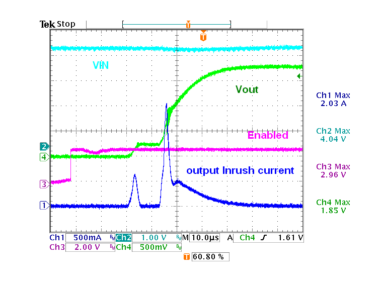

Hi team,
We use the LDO LP5907QMF 1.8V to measure the output inrush current with Cin 4.7uF and Cout 4.7uF.
The test result show as below.
In datasheet, the current limit is 500mA.
Why the current limit doesn't work?
Thanks.
Prescott
  • " ... LP5907 ... output inrush current ..."
    The in-rush current is due the delay time required after the EN pin goes high, for all the internal circuitry, including the current limit circuitry, to power-up and stabilize.
    The Isc current limit applies when the device is already fully powered-up, operating normally, and then short is applied to the output.
    Your test results appear to be typical/normal behavior for LP5907.

  • This behavior is not something that has been fully characterized.
    Typically, customers are reporting, and I have observed on the LP5907 EVMs, that the in-rush current typically peaks in the range of 30 to 60 microseconds after the EN pin goes high.
    There appears to be some variation In this time due to Vin and/or Cout. This has not been fully documented.

  • The following image is an extreme case, well outside the recommended operating range, but it clearly shows the transition from the momentary in-rush current to the controlled current limit (Isc). The Isc current is held until either the LP5907 Thermal Shutdown is activated, or the output voltage is reached.

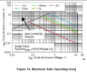

    Customer ask us to provide the Maximum Safe Operating Area of  LP5907 internal MOSFET like below.
    Do we have this information?
    Thanks.
    Prescott
  • No, we do have not any chart SOA like this.
    The LP5907, like most modern LDO's, have internal active circuitry that will protect the device by limiting the maximum current and/or the maximum junction temperature.
    It is the customers responsibility to assure that the maximum input voltage is not exceeded.
