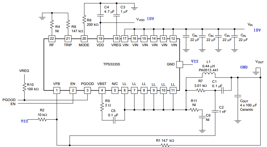

I want to generate -1V/20A (DC-DC), so is it possible to work?
If I provide 10V to VDD and short Vout to GND, The TPS53355 "GND Pin"(VSS) can be generated minus voltage? like below picture.
