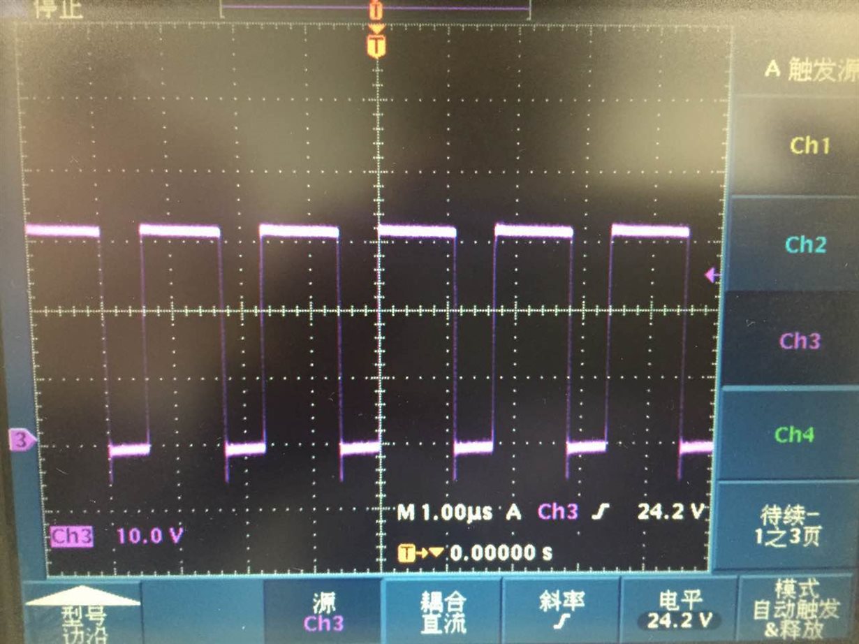

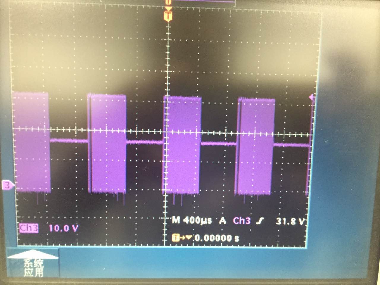

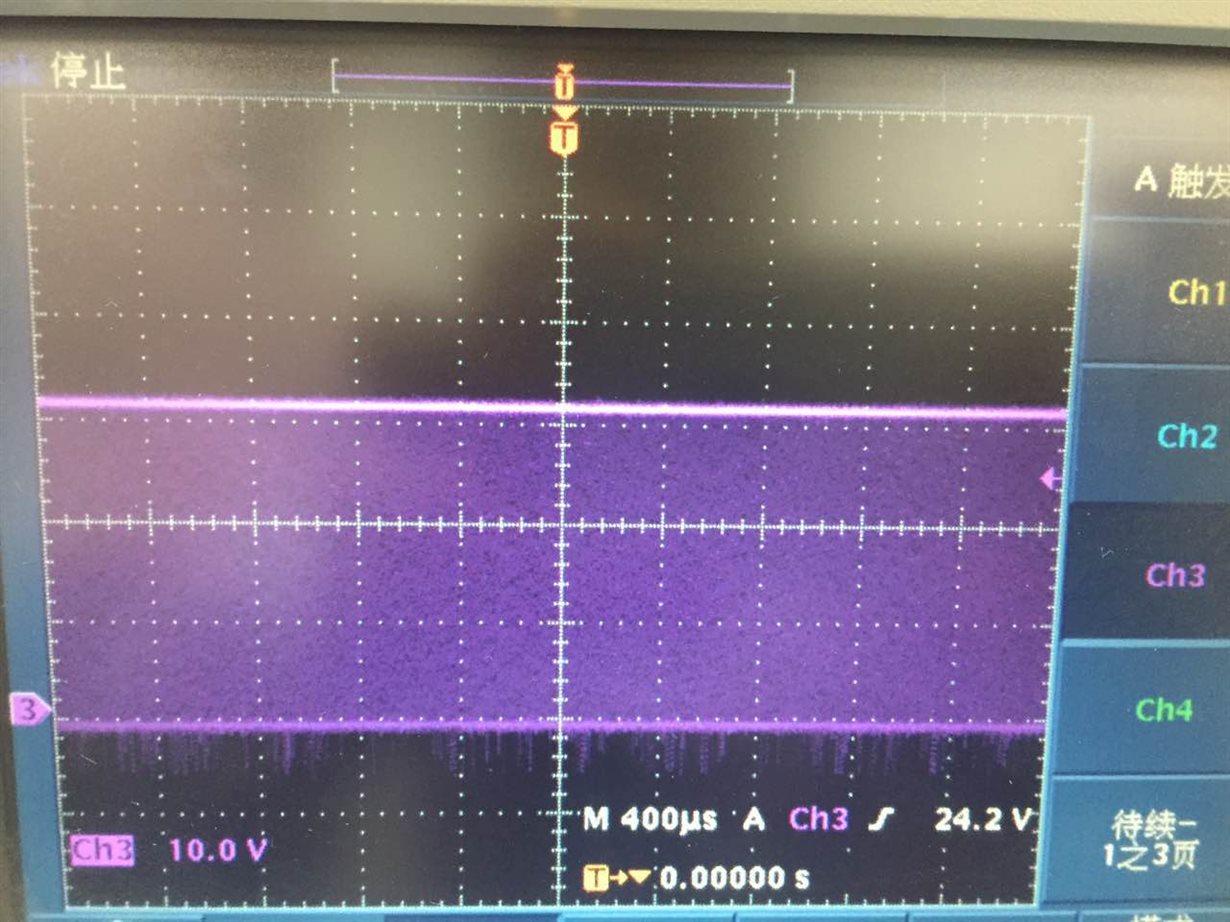

    And I have tested it in TPS92512 EVM and found the following issue.  There still have the audible noise in EVM.  The first waveform(PDIM pin ,input 1KHZ 50% PWM) has the audible noise, PWM will stop for a long time. the other two waveforms(PDIM no input)  is normal.  Have you face this issue in EVM. If you don't meet this issue, I will try to find this issue in EVM.
  • There is no audible noise when using Analog dimming , But there has audible noise using PWM dimming. And I found there has a big difference in two input paths.
  • That is normal operation during PWM dimming. The part stops switching when the PDIM pin is pulled low, that is how PWM dimming is achieved with a switching regulator and many of them will make noise during PWM dimming due to the caps and/or inductor. It will need to be remedied like I mentioned in my first reply.
