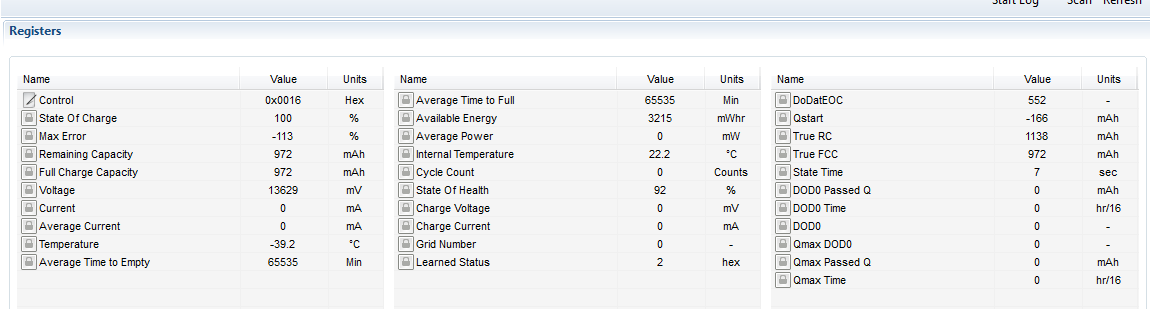

I have used the EVAL board to go through the optimization cycle and the my max error rate is at 1%
I have loaded all the chemical files etc before the optimization cycle,
After all was done I used bqstudio to create the goldenfile from the eval board.
I have Now program this goldenfile into my "blank" device with the same battery pack as used on the eval board I see the full charge capacity is at 1633mAh instead of 4412 as on the eval board.  If I go in to the data I can see all the settings are correct as per the eval board.
What I'm I doing wrong? I was under the impression that If you create a golden file that all will be working on target devices.
