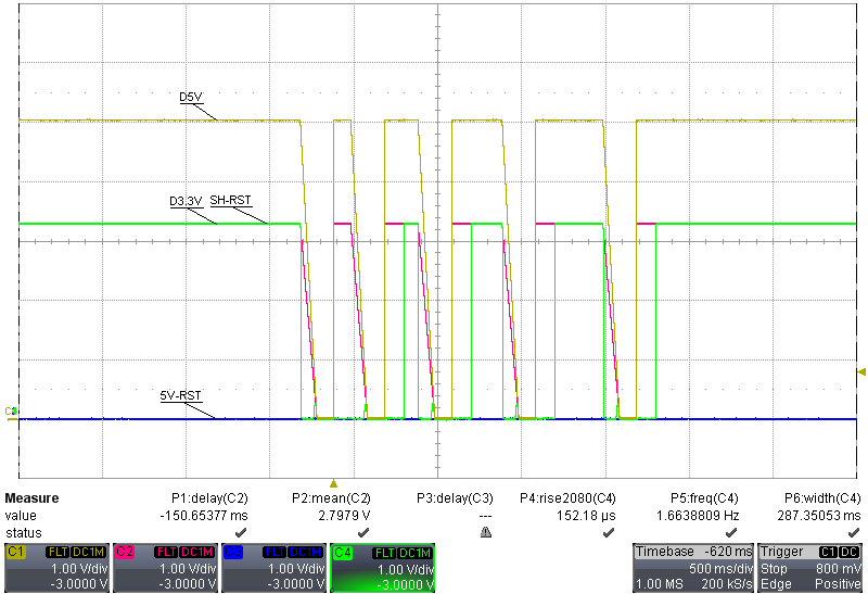

Our customer is testing TPS3106K33.
When repeating on and off of the power, output is sometimes fixed at low.
Is there a regulation in time on from off of the power?

Our customer measured attached waveform.
When VDD isn't dropped to 0V, It may reappear.
PAN-M
Hi PAN-M,
Thank you for sharing the scope shots. We are still not able to reproduce them, but there is one more think I'd like to ask you:
Is there a particular reason the customer has a cap at the /MR pin? I'm asking because we do recommend to leave it floating or tie it to VDD if it is not used. Other wise it can end up somewhere in between 0.3 x VDD and 0.7 x VDD and cause an undefined state.

Hi PAN-M,
I guess that your customer put the cap there because of section 8.3.2. The paragraph witch mention the 0.1µF cap only applies if /MR is used.
If the cap is used as in the provided schematics, the /MR pin would keep the voltage of VDD up for a short time, even VDD was turned off. So technically you are exceeding abs max (/MRmax = VDD + 0.3V).

Nicolas
Yes, my customer put the cap.
And also when having taken this cap, this problem disappears.
Our customer will finishe design with removing cap.
