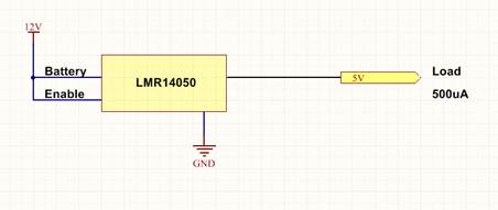

My Customer is using LMR14050-Q1 for car infortaiment
LMR14050-Q1 is set to have output of 5V, and it is supplied to a MCU as shown in the diagram below
When MCU goes to standby mode (current consumption) is about 500uA maximum
Do you know how to calculate the total consumption for this DCDC (it is always ON)?
