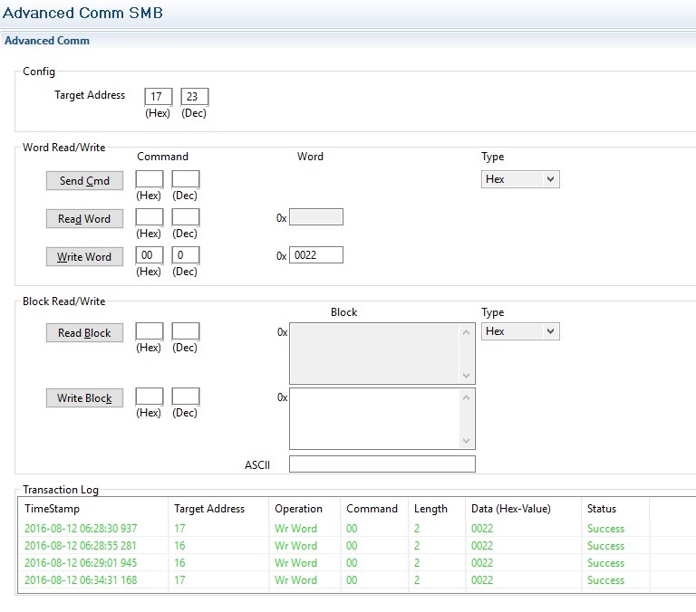

I would like to understand whats going on on the SMB-Bus between master EV2400 (USB-Module) and slave bq78350-R1 on my EVA-Board bq76930EVM.
(bq78350-R1 talks to bq76930, which is also on the board via i2c. But this i2c is not connected to EV2400 USB-Module).

I tried this and it worked well! Teriffic!
I have a LED+resistor connected to Pack+/- as load and the LED went on and off via this command.
But I have to understand whats going on on the bus in order to develop my application.
When sending the described command 0x00 0x0022 to 0x17 (Button "Write Word" in "Advanced comm SMB" of bqStudio) I measured the following:
Start 0x16 ACK 0x00 ACK      0x11 ACK      0x00 ACK      0x4B NACK STOP
When sending the described command 0x00 0x0022 to 0x16 (Button "Write Word" in "Advanced comm SMB" of bqStudio) I measured the following:
Start 0x16 ACK 0x00 ACK      0x11 ACK      0x00 ACK STOP
Now 2 questions:
1.
Why is there a difference in the observed signals between Adress 0x17 and 0x16?
Does 0x17 make sense at all when writing, it is not even put onto the bus?
2.
How can I understand the measurement, where is this command 0x0022 (ManufacturerAccess() - FETControl)?
Is there any document ehich can be of help here?
