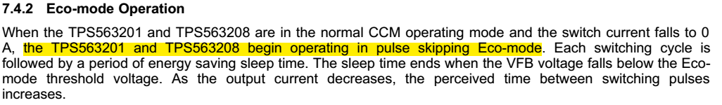

TPS563201 and TPS563208 which one is support Eco-mode?
Other Parts Discussed in Thread: TPS563201, TPS563208
Hi Sir,
About datasheet description let me confuse as below highlight,
May I know TPS563201 and TPS563208 difference about support Eco-mode? thanks.
