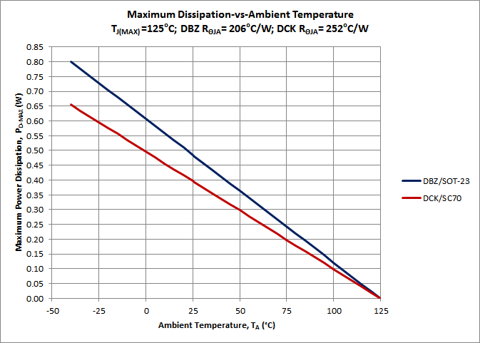

Hello Team,
The customer wants to know the  Maximum power dissipation (please specify ambient temperature at which this parameter was tested/estimated) for the LM4040C25MDBZTEP. I cannot find any data regarding this. The closest I could find was at
 https://e2e.ti.com/support/power_management/linear_regulators/f/321/t/522846
