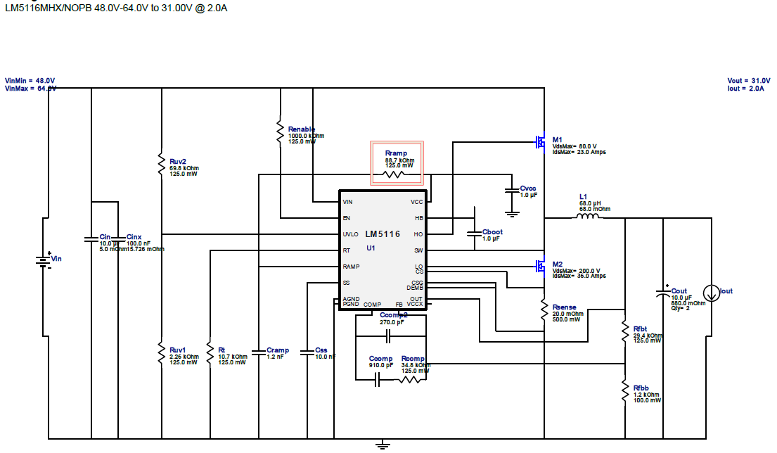

I have designed a DC/DC converter using the LM5116 by simulating it with the webbench tool according to following specifications:
IN: 48...80V
OUT: 31V, 3A, high inductive load.
The VCCX pin is connected to an internal DC/DC converter with 12V supplied by the output voltage of this LM5116. Additionally to the design below, the UVLO input is connected to a 1uF cap to GND and a diode connected to VIN. During normal start-up conditions, the VCCX voltage is present ~50ms after start-up but are nut present on those units, of course.
I have currently 2 defective units with no switching of the output. They have operated several hours and failed suddenly. Unfortunatelly I have not recorded any data during the fault conditons.

    Please forward the schematic.
    Tim
  • Hello Tim,
    please see attached the schematic.

  • Andreas,
    Can you provide the UVLO voltage? And can you also confirm that EN is really 32V? Provided the schematic is correct , VIN = EN voltage.
    -Garrett

  • Andreas,
    In the first schematic that you provided it shows that you are using the VCCX pin. In all the test above are you using the external 12V supply that is indicated? If so the VCC voltages should be 12V.
    Also, In the below waveform UVLO should follow VIN because it is connected by resistor divider. Did you change the schematic at some point?
    The peak on RAMP during shutdown should not be an issue.
    -Garrett
  • Hello Garrett,
    Q: In the first schematic that you provided it shows that you are using the VCCX pin. In all the test above are you using the external 12V supply that is indicated? If so the VCC voltages should be 12V.
    A: This is acutally the issue with the failed units. Because the IC does not work as specified (no output because of no switching of the external MOSFETs) there is no voltage at VCCX and the controller uses the internal voltage during start-up. Typical time for a working unit is 20ms from swithcing on until the 12V supply is active and can supply the controller at the VCCX pin.
    All units decribed in the table below do not start because of different reasons (EN, UVLO, VCC), but each of them are build in identical electronics with the same schematics.

    Q: Also, In the below waveform UVLO should follow VIN because it is connected by resistor divider. Did you change the schematic at some point?
    A: There is no change to the schematics. This is one of the odd behaviour of the failed units.
