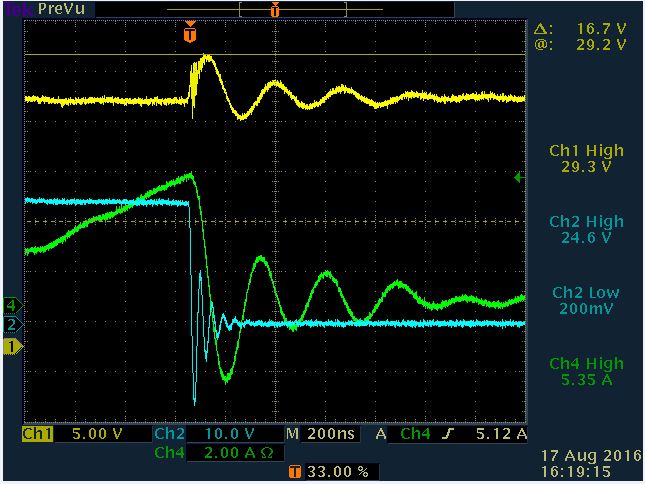

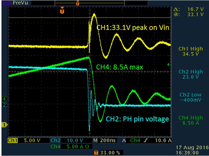

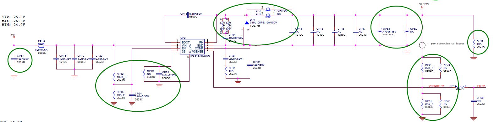

Could you help review the TPS54531 Vin waveform and schematic? What is the SOA for the TPS54531? If over 30V max voltage in 100ns, will that cause the TPS54531 damage?
It is on MP stage. And the fail rate is high. The pin2 Vin are brown out.
two Vin/Vout design.
                   1.     Vin  = 25.3V /  Vout =10.62V / Iout =      2.72A
 2.      Vin  = 25.3V /  Vout =15.71V / Iout =      2.72A
schematic.
waveform: the SS cap was put 100nF
