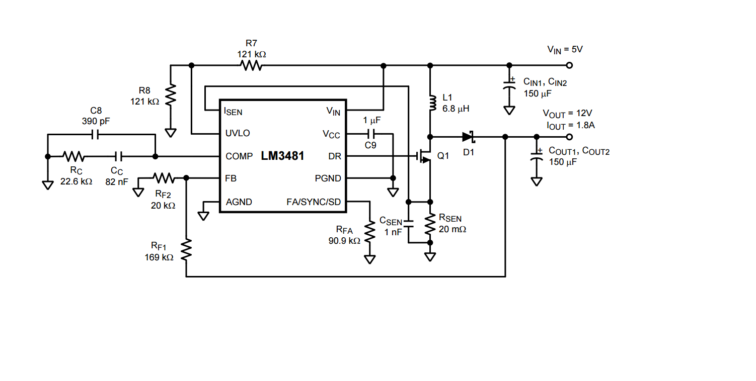

  • At Vin=3.3V, Vo=5V/Io=10A application, if the conversion efficiency is 0.9, then the input current =(5*10)/(3.3*0.9)=16.83A,  the indcutor current =Iin*(1+K/2), where K is  the current ripple coefficiency of the boost inductor, where K=0.2-0.4, if K=0.3,  the peak inductor current is about 19.4A , this peak indcutor is also the peak switch current.so you will have to found a 20A Boost converter instead of the 10A boost converter..This is the  reason why TPS61088 is  not fit for this  application.
    I suggest you use LM3481,  this is a  boost controller, need external MOSFET and recfier diode. Please check the folloiwng schematic. But this part is not belong to our product line.

  • As posted previously, you will need switch current of close to 20 A. Can you look at LM3481 as suggested above?
  • Yes, but i din understand .
    how its function
    could you explain me basics of this so that i can understand better.
    If you have a look of this. its also have a switch current of 10A then how will it deliver 10A load current .
    Thanks.....!!!
  • It does not have EN pin as well. so it will be very difficult to keep it shut down mode as well !!!
