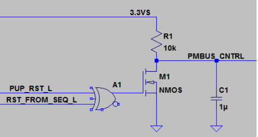

  • Thanks for your valuable input.
    this is the continuation of the above discussion.
    Instead of driving the Control Pin signal from CPLD, we are trying to form the attached logic externally. At present CPLD(3.3V) and UCD(3.3VS) are powered from two different 3.3V supply.
     T
    PUP_RST_L is coming out of one of the GPO from UCD, formed by all Power good signal consideration. Till all the power lines are crossing its power good level PUP_RST_L will go high till then it will be of LOW.
    RST_FROM_SEQ_L is coming out of another GPO from UCD. This checks all the UV & OV signal levels. Any fault indicated then, it will go high.
    Will this implementation would be acceptable to initiate On/Off control?
    Felix.
    When both PUP_RST_L & RST_FROM_SEQ_L signals are low PMBUS_CNTRL pin will be pulled-up by the 10k resistor.
  • Probably won't work. The OV/UV fault status will keep set when you toggle off the CONTROL, and only be cleared when you toggle on the CONTROL, assuming these rails are controlled by CONTROL. You may try on EVM.
    If the purpose is to power cycle the rails when some rails are not power good or have OV/UV faults, you can use the re-sequence feature in fault response configuration.
    If the purpose is to use CPLD to power cycle rails, and the CPLD will lose power itself, you may consider to use System Reset function of the device. You can use a GPI (signal toggled by CPLD) to trip the System Reset output. The System Reset pin output can be routed to CONTROL. The System Reset pin can be configured in a way that when GPI is deasserted, the System Reset pin outputs a pulse. The pulse should be long enough for all rails to properly sequenced off. All GPIO pins' polarities are programmable, so you can have a GPI high-level as de-assert, and trip the System Reset pin pulse. You can try it on EVM.
  • Hi Zhiyuan,
    Thanks for your input. We still need feel the above discrete implementation works well for our uses cases, provided our below understanding on the functionality holds good.
    1. We are trying to access PMBUS_CTRL pin mainly to have option to implement Power down sequence on different cases like Power is not Good, any OV/UV fault on the rails & Power recycling after CPLD Programing is done. So, it may not be possible for us to drive the System Reset pin(GPO) to Control Pin by considering only Power good & GPI configuration that will be driven from CPLD after programming.
    2. If the OV/UV flag has been set, then what clears the flag? Clearance of Fault (or) Device Reset (or) Both (or) Control pin Toggle from LOW(OFF) to HIGH (ON) is sufficient enough.
    3. We are formed this external circuitry to implement the same logic that was planned to implement inside CPLD. This is mainly to avoid any situation that the CPLD supply(3.3V) goes off so that the PMBUS_CTRL Pin cannot be driven. Discrete implementation is being done with a separate supply (3.3VS), which was derived from board main power input without any control. Same 3.3VS is also powering the UCD. Here, how come the CPLD implementation alone can work and not the discrete implementation?
    4. These are the different logic scenarios we are foreseeing in the above implementation using the EX-OR Gate.PUP_RST_L is formed by ANDing all rail power good, driving high when logic is correct. RST_F_SEQ_L is formed by ANDing - ORed rail UV & ORed rail OV fault settings, driving high when no UV & OV fault occurs.
    S.No Scenarios P_RST_L RST_F_SEQ_L O/p ExOR PMBUS_CTRL
    1 All PWR Good. No UV/OV Fault 1 1 1 1
    2 All PWR Good. UV (or) OV Fault 1 0 0 0
    3 PWR Not Good. No Fault 0 1 0 0
    4 PWR Not Good. UV(or) OV Fault 0 0 1 1
    a. During when the rail is not started (#4), all GPIO will be low.  In that case PMBUS_CNTRL pin will see a High, allow UCD to start functioning.Is this understanding is right?If it is right, then this case will be retained till all the power rails are coming good without OV Fault. Now all powers are good and no fault (#1), control pin will see a high always.
    b. Either Power is not good (or) any Fault occurs, then Control pin will see a low and UCD shut down (#2 & #3). Do you think that the problem comes here, when the UV/OV flag has been set, some external mechanism is needed to toggle the Control pin (or) Reset the device?
    c. I have a point of view, when power is good and OV fault happen (#2), control pin will see a low and UCD will be shutting down. In this case, the PWR Good also will go low and as per above logic the Control pin will see a high, which in turn reset/re-power the device & reset the OV flag. Then the logic cycle starts. This will go until the OV fault is removed.
    4. We are not accessing the PMBUS lines in our design. So, we can not implement OPERATION option for power down, as you suggested on before comments.
    Kindly help us to resolve the issue that we face on this power down implementation.
