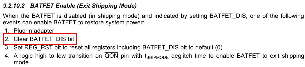

Please let me ask about exiting shipping mode. My customer consider to clear BATFET_DIS bit to exit shipping mode, then can we clear it via I2C communication during shipping mode? I mean that I'd like to know if I2C module in bq25890 is activated during shipping mode.
Please let me know how to clear the bit if I2C module is not activated during shipping mode.
