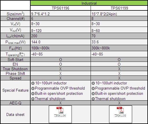

Hola,
Below is the table of TI's LED driver specification that we have designed in our project and please someone can help to correct if its some data incorrect?Thanks ~
In addition, does TI have the latest road map for the above both PMIC and LED driver for car LCD application?Thanks ~
