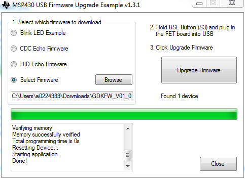

Where could I found "Firmware Update Image" for the MSP430 of the BQ27GDK000EVM board?
Christophe
  • see attached.

    update the firmware on the gdk by downloading the msp updater below.. the .png image shows what the updater looks like. Plug in the gdk and then from the updater navigate to where you saved the file GDK_V1_06_INA220.txt and then update
    http://software-dl.ti.com/msp430/msp430_public_sw/mcu/msp430/MSP430_USB_Developers_Package/latest/exports/MSP430_USB_Firmware_Upgrade_Example-1.3.1.1-Setup.exe
    Make sure to move the button to the appropriate locations for updating gdk firmware, and then for updating ev2400 firmware.
    thanks
